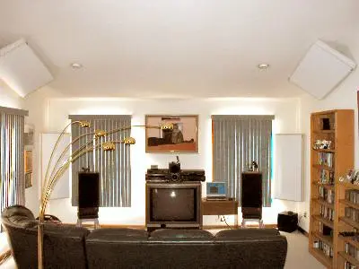

> How bout STEREO bass traps! Better yet...SURROUND TRAPS! <
Done.
--Ethan
