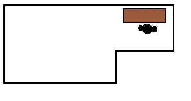

What kind of room are you mixing in? That could be a lot of the problem.
Here's the room. Its lightly "treated" with some Auralex. Those awkward black circles are where I sit. Also, yeah, our current drummer sucks. We're getting a new one soon...lol.

That pic pretty much explains the mix issues. Can you move your desk?
I can, but the big space is where I usually do the tracking. I could probably move it though and make it work.
What do you recommend?
I'd get out of that little box and out of the corner. I'd probably go against the left wall, so rear reflections would be the longest. Put your aurelex at the early reflection points.
