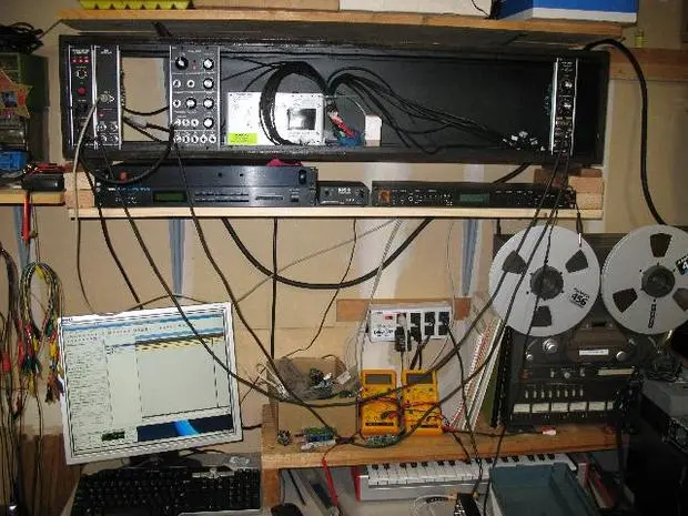

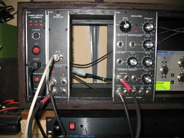

I decided a while ago that I wanted to put together a modular synth. I ran across Synthesizers.com which sells both full systems and individual modules as well as a pay as you go starter system. At this point I've got enough modules to hear the first sounds. So far so good - a lot to learn. MIDI from Rosegarden to the MIDI in module to the first osc and thus to a VCA.
With telescopes you celebrate first light. So this is a first sound celebration with a little Bach, Pachebel and Mussorgski followed by a Merlot....

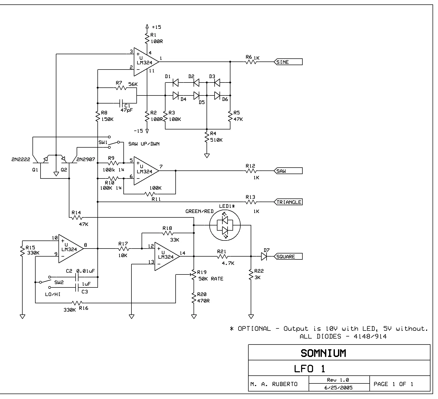

As for LFOs try mine. It's got the economy of parts verses functionality as good as it gets. It's very thoroughly tested and a great performer. I based it on a simpler standard design you'll find all over the place.

Say, What schematic capture program did you use?

That looks like expresspcb's tool . . . free but not open source. I loves me expresspcb myself, they do all my PCBs :)

You guessed it bro. :)
I use them too for my PCBs. In fact I have a PCB designed for the above schematic in ExpressPcb. Send me an IM if you would like the .pcb file for the LFO. The PCB is designed to take advantage of their "economy" three piece deal :D
