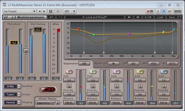

Step one - mix in some studio atmosphere via some light reverb. I think the drums low fi is on one hand holding the song back, and on the other giving it some character. I tried to bring things up a notch adding reverb.
Then I did something similar to what I suspect you did, using a multiband compressor to add some definition to the lowest and highest frequency ranges (aggressive compression used lightly). (attachment 1)

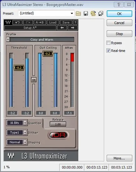

Dumped this from Sonar into a WAV, then in soundforge added a modest amount of warmth (probably wrong term to use here) with a L3 setting Ive just recently started toying with, which seems to bring the overall gain up without adding harshness. (attachment 2)
Not sure if any of this helps. lol
The rhythm guitar during the lead could come up as previously suggested, otherwise I think things are pretty good.
