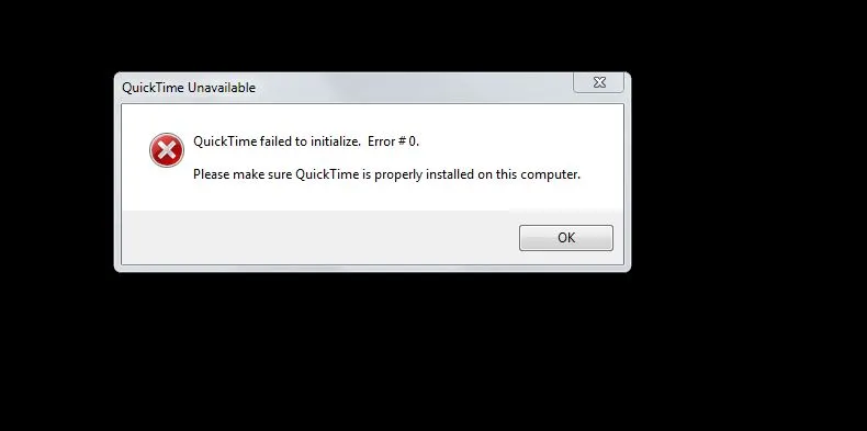

I can't listen to your samples as it requires Quicktime. That will not ever again be installed on my PC. Can you just upload the file via Advanced panel here please? :)
Jimmy, right click the wav files to download.
I can't even get to the wav files without Quicktime installed.
Long story but I just will not have Quicktime on my PC system. It caused me too many issues in the past.
I don't have Quicktime installed. Try with this rar archive. If you can't play wavs at all I don't know what to tell (I'm not the expert here...:eatpopcorn:)
