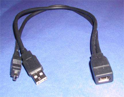

just use something like this:
http://www.pccables.com/70939.htm
It will convert a 4 pin firewire connector to a 6 pin that gets power from a usb port

It should providing that you dont draw more than 500 mA. But if it's vaporware, thats that.

Your missing the point, it gets power from a USB port and turns a 4 FW pin into a 6 pin powered
