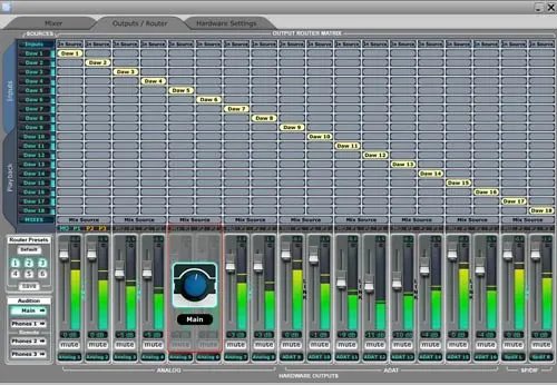

My firestudio has a bajillion inputs/outputs, and I have no idea which are labeled which in the software. There like 16 inputs, 16 outputs, and none make any sense. It's pretty much like pick a number and try it, only the possibilities with so many connections is almost endless. It's a "matrix" in the software that you have to route in order to get the inputs to communicate with the outputs etc. Maybe I just don't know how to word it right. It's just locating the physical number of the send/return of the firestudio. I've checked forums, support websites to no avail. Any easy ways to just test connections to just go through each one?

Ok, bajillion and 16 are vastly different. Chances are you have 8 basic inputs and outputs and 8 ADAT inputs and outputs. Ignore the ADATs for now. Just send the signal you want processed out output 1 into a rack input and out a rack output to input 1 on the firestudio.

It's not the actual inputs that's the problem. It's the fact that I don't know how to "activate" or whatever the channel 1 send/return for my patchbay. I also found out that if I plug that into the patch bay, I lose that preamp... I just can't seem to catch a break on any of this. If you saw the control panel on this firestudio, you'd want to kill yourself. It's so extraordinarily confusing...*gasp*
You mean this thing? Look, do you have an actual hardware patchbay or are you talking about this matrix/mixer for the firestudio? This would be much easier if we could use some common terminology.
Unless you like being confused...
Here is the manual, read it please. I am not here to learn your gear for you.

I have both jamaican. I have the matrix mixer and a neutrik 48pt patchbay NYS-SPP-L. You have to "configure" the virtual inputs/outputs to the physical inputs/outputs, which makes things REALLY confusing...

I have a send and a return on the back of the firestudio used for sidechain FX on channels 1 and 2... I cannot get the firestudio to send the signal from my DAW through the send, to be sent back through the return. I seriously don't know how else to put it....
