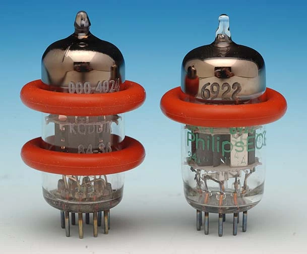

You guys nailed it. It came down to Ch1 first gain stage preamp tube. Not even using Ch.1, but totally removed the tube and the jingling stopped. So I wonder if I need to look into these:

Glad you found it! The tube dampers should help for sure. Unfortunately this is a slight drawback to the combo amps that we love where the tubes sit so close to the speaker. Not sure what brand of tubes are currently in the amp, but I will take a guess and say Groove Tubes. Though I really like these, they have done what we are talking about more than some others.

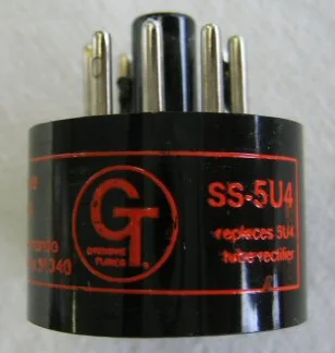

Amp tech says the symptoms sound like the bias is off, but also spoke against rectifier tubes from a personal preference. He said to try one of these (solid state rectifier plug) and if I didn't like it, then replace the rectifier tube and he would re-bias if it still needs it.
