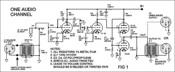

If you are so Inclined you could even build a Hamptone for really cheap as it is a quite easy curcuit....
Here:
Here:
Minion, have you put one of those JFET's preamps together? I have been tempted by this before. Simple or no?
hey minion, thats not showing any phantom power circuit right??
Hi, No I haven"t built a Hamptone yet but I am thinking about it.. I built mostly Solid State Equipment and haven"t done much Tube stuff...
No it doesn"t look like there is a phantom power curcuit but it is extremely easy to add one as the Phantom power can be added by just adding a couple 6.8k resistors and a couple 47uF DC Blocking Caps....If you need to know how to incorporate the Phantom Power let me know and I"ll fill you in....
From what I have heard over at the Prodigy Forum this is a really easy Project and it has a Real Smooth Tube sound but a Little Noisier than most Solid State curcuits which is normal with tubes.... Pluss it is a Very Inexpensive Curcuit to build if you can get the Tubes and Sockets and a Good Power supply.....
Cheers
Cheers
