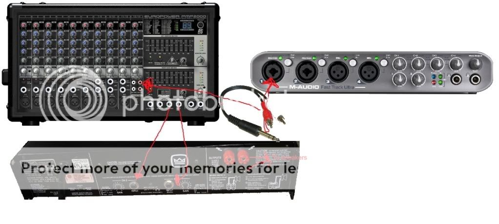

You'll have to excuse my newbness I don't even know what FOH stands for. But i'll try to be as clear as possible.
We have a crown power amp but our old mixer went the way of the old guitar player (out the door). So we are using my pmp2000 as a mixer using the left/right outputs into the power amp because it's a much bigger amp than the one built into the mixer.
So from that setup I figured I could use the stereo RCA outputs on the front of the mixer, feed that into the input on the fast track and record the mix coming from the pmp2000 that way.
So to sum it up. mixer to power amp, RCA tape out from mixer into channel one of fast track. Adjusting the mix via the mixer.
Maybe this horrible illustration will help. haha
FOH = Front of House....ie what your PA mains are sending to the amp.
My suggestion is to use the monitor out to feed your Fast Track.
You've got monitor sends on each channel, so the ideal thing would be to set up your monitor sends just like each main channel send, then adjust each to your liking. That way you have 2 independant mixes running...your FOH mix and your monitor mix which you can run into your interface for recording.
well i'll be damned i never thought about that. That makes a lot of sense. I'll definitely have to try that. Thanks man!
teyshaBlue bet me to the punch.
Do as he stated and you should be good too go
You guys have been a ton of help. I'll let you know how it comes out. Maybe i can get some recordings up if anyone is interested in the fast track to hear some quality.
