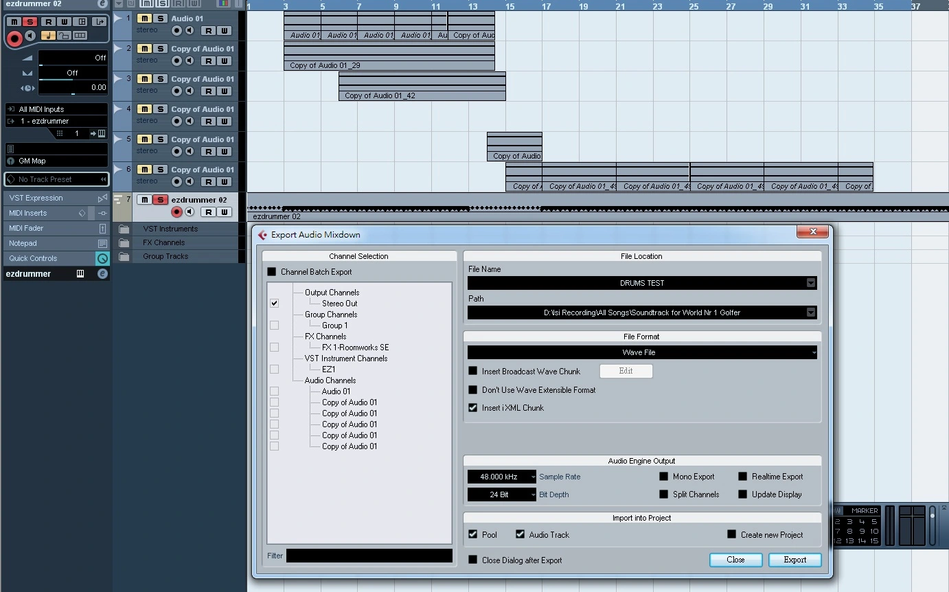

Including an image of my Export just to be sure!

Not sure how your drums tracks sound different. You probably need to explain or post a clip. There could be several things going on. The first obvious question is how are you listening to your drum tracks?? How are you able to compare between pre and post export??
I noticed you're trying to record a soundtrack, so I'm assuming this project will be used in video at some point. If that is the case, you should export to 24 bit and 48khz sampling. Not absolutely necessary as most video editors can handle most any sample rate, but eventually it will be converte to 48khz, so it might as well happen at mixdown.
