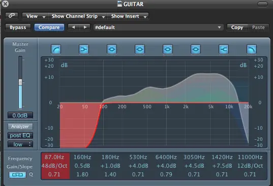

Really concerned that it is contrary to what is normal... this is the EQ that makes it sound bareable:
literally the most ridiculous looking EQ i've ever produced
I'd post sound snippets if I could of the guitar with no FX straight into the DI then the EQ and reverbs added etc
I've run into this before when using Logic's Amp Designer. I'm usually forced to max out the treble and presence in the Amp Designer and then sometimes add on some extra high end in an EQ afterwards. When I use Amplitube it's not quite as much an issue.

Personally if I were having problems with not enough high end I would try and get the tone without the EQ first. Turn the bass knob down on the amp sim, turn the treble up etc. I notice I usually do a HPF anywhere from 90-130hz. Ive even gotten up to 180 before. And then a LPF anywhere from 7khz up to 12khz. It also depends exactly on what style you're going for. I tend to cut around 4100khz to get rid of that fuzzy noise from amp sims. If you still aren't getting enough high end then I would just do a low shelf and take it down a few db's and see if that helps any.

Managed to fix the treble issue now after lots of playing around with amp designer, compression, and using fabfilter pro EQ plugin.
Still struggling to get the most realistic sound I can through DI'ing.. the guitar just doesn't seem to have a lot of body to it, even boosting some of the mids doesn't help a lot.. hmm.. spose it's just a trial and error process
