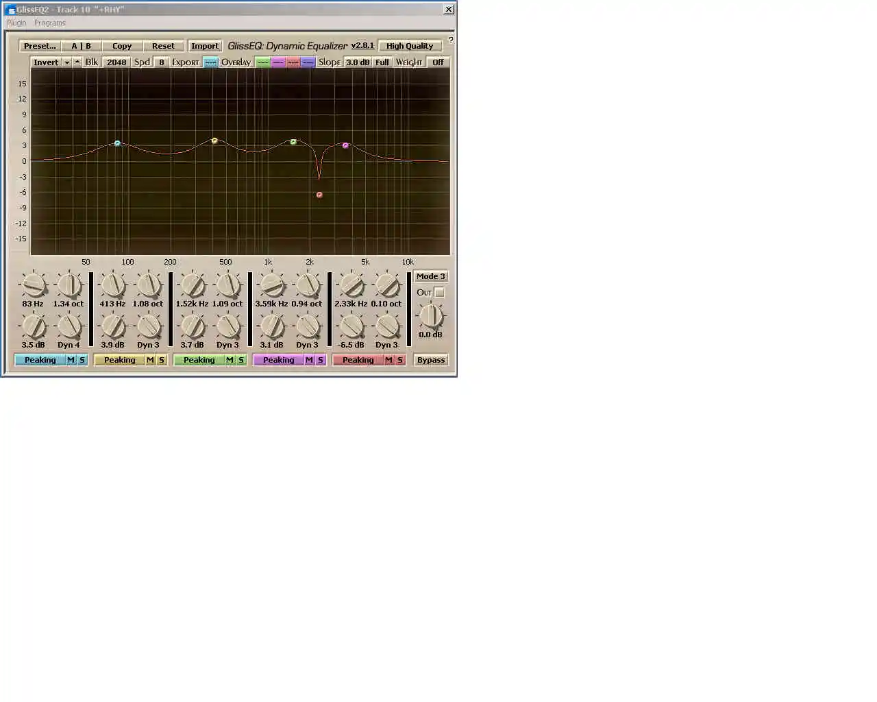

once you have the best source gtr tone and mic positioning you can achieve, here's a very ear friendly EQ curve. gently sweep around these EQ points and adjust the Gain and Q to taste. Keep the Boost fairly Wide and the Cut very narrow. Learn the benefits/pitfalls of each and your end result will improve.
Boost...
80Hz - Bottom
400Hz - Tone
1.5KHz - In your face
3.5KHz - Bite
Cut...
2.3KHz - Annoying to my ears. Use narrow BW (Hi Q)

You can't expect every frequency you sweep through to sound pleasant, assuming your examination consists of a sweep. Just because you hear harsh frequencies does not mean you should just get rid of them. If you did that with every element in the mix it would sound horrible, guaranteed.
The important thing is how the guitars blend in the mix. Pay attention to how they compete for frequency space with other instruments.
Regarding Sonixx post of his eq curve, you can't assume that this will work for you. You are not using his equipment or mixing with his other sounds.

try again... re-read my post... sorry, but this has nothing to do with equipment. my EQ curve is a very good starting point for guitar distorted or not...
I'm always amazed at comments like this one, but I shouldn't be. how suggestions get totally discounted. whatever, I know this EQ is a very good starting point. believe it or not.

Actually, the equipment does matter, on both sides of the microphone - including the mic itself. Just the difference in resonances in the guitar body itself can make all the difference in the world as to whether or where one may notch or boost any given frequency. And that's just the start of the variables. Then there's the pickups, the amp, the cab, the mic(s), the mic placement, the preamp, fitting in with the rest of the tracks, each with thier own EQ requirements, yada yada yada.
The thing about "starting points" is that they are just that, they are starting points, nothing more. At best, that makes them no better or worse than any other starting point, including a flat or bypassed EQ. One can easily start there as well and wind up in the exact place they want to be just as easily and just as well.
At worst, however, such non-flat starting points can unfairly bias the listener into thinking that the solution should at leat somewhat resemble the starting point; maybe a couple of dB here or a couple of Hz there, but an EQ curve that doesn't even closeley resemble the starting curve is not only implied to be wrong, but isn't gotten to any faster or easier from that starting point than it is from a flat EQ.
I've used curves similar to the one you show on guitar before. But frankly, I also used a thousand curves that resembled that curve about as much as I resemble Angelina Jolie.
Your mileage apparently does indeed vary, but my guess is that your mixes and/or your sources don't. Do you really think that Joe Satrani on "Surfing with the Alien" needed anything close to the same EQ as Dick Dale did on "Surfin' Safari"? Or even that C.C DeVille's Flying V gets anywhere near the same EQ as Dave Davies' Flying V?
Every situation is different. Best IMHO to start with zero EQ, actually use one's ears, do a sweep or two to see what sticks out, test it against a faders up mix, and go from there.
G.
yea, many times i need less 400ish, and sometimes i need more 2k ish.
don't usually find the need to boost 80hz (sometimes do)
bassically making that starting curve, exactly the oppisite of what i need sometimes.

Have you read slippermans thoughts on guitar eq'ing? You should, he'd have you cutting some of those frequencies you're boosting and after using my own version of his method my guitar tracks have become a lot more solid.

the poster asked a question... I stated how I go about it... there you go. it works for me. listen to my stuff. like it, then thanks. don't like it, that's cool.
you all want to have a pissing match about absolutes, go ahead.

Simma down now, nobody's pissing on your eq parade. Sorry if any of us came off as putting you down, if it's working then way to go man. However I thought my way was working for 3 years until I tried somebody elses way and then I found out my way wasn't as good as it could've been. Seriously, if you haven't read badmuckingfastard do it. I had no faith in doing things slippy's way but when I finally did I found out that it works so much better than my way. I'm glad your way works for you though and I'm actually going to listen to your stuff when I get home.
