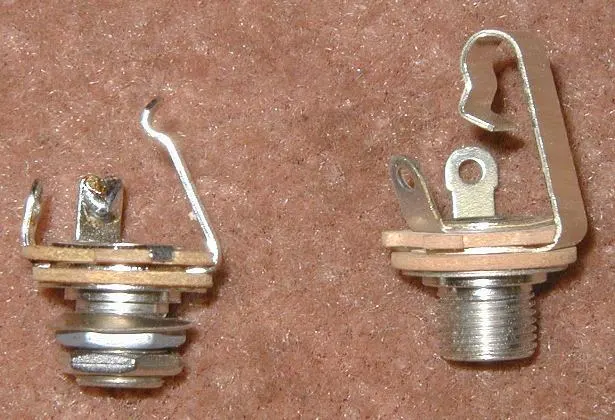

The cheap jacks used by most Asian manufacturers in cheap guitars (all Epiphones) are made of a very light gauge and cheap metal. Also, the geometry of the design makes it very easy for metal fatigue to cause them to make intermittent contact. A good jack is made of a much heavier gauge of steel, and is designed to combat the stress of constant plugging and unplugging.
I was going to put up some pictures of this, but I can't find any of a cheap jack right now. It's enough to say that a good Switchcraft jack will last you years longer than a cheap POS jack.

Here you go. The one on the left is a cheap POS, the one on the right is a good Switchcraft #11 (the one you want). It's hard to see what I'm talking about as far as the gauge of the metal, but you can see the shape of the tip connection. The Switchcraft spreads the stress of plugging in out over a much larger area of the piece. With the cheap jack, it all gets concentrated right at the more than 90 degree bend at the bottom. These things fail as fast as you can say POS. The Switchcraft ones will get loose over time, but you can bend them back ("retension" in geek speak) for decades before they fail. You can't bend the cheap ones back.
Also, look at the solder terminals. The Switchcraft ones are much easier to deal with.
