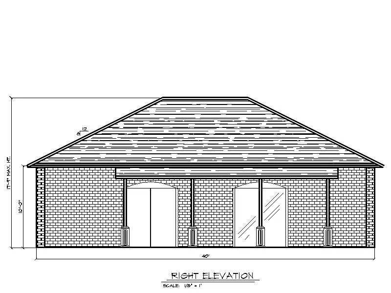

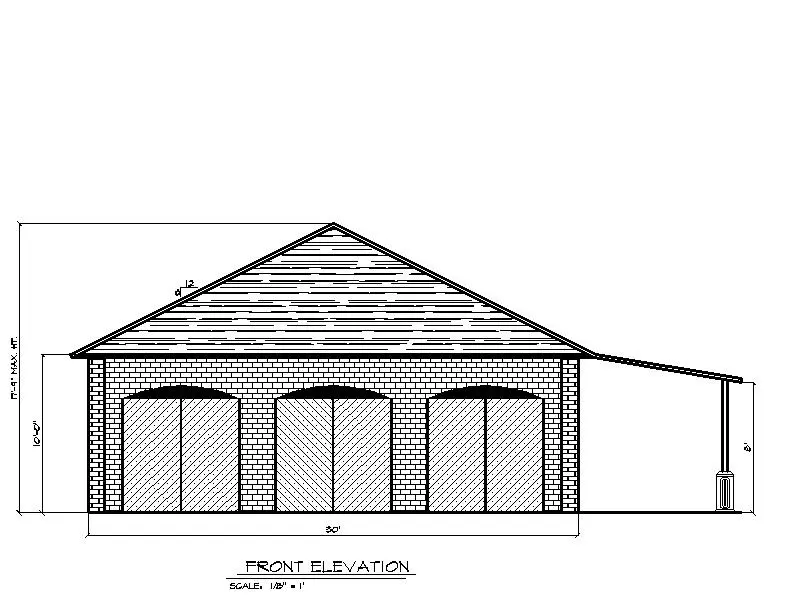

So, given that, I thought I'd post some drawings of the exterior elevations. I've always said that the studio MUST be faithful to the existing residence in architectural character, and I want the exterior to have this "Carriage House" feel to it.
The "front elevation" shows 3 doors, but only the midle one is functional, the other 2 are just architectural elements.
The "right elevation" shows 2 doors and again only the far right door is functional. It leads into the control room.
...and the "front" elevation.
Hi Michael, looks great! Are you doing the masonry yourself too! Brick should work really good for iso. I've never heard of "carriage house". Is that in reference to old "carraiges"? Anyway, good luck on the submittals. Everytime I've had to deal with BID, it was a lesson in how stupid I really am. ;)

As far as BID, the only thing that has me concerned is the ingress and engress of the building as it pertains to fire code. I'll let them comment on my lay-out. If it doesn't meet code, I'll end up with another door or window.
Hi Michael, thanks. If your property is zoned Residential, you probably won't have any problem. But I'm no expert. Hey Michael, what type of diffuser are you building? I'm designing mine right now, but thats another story. I'm curious about what defines the parameters of diffusers in regards to room size and geometry. Do the room dimensions, as far as supported wavelengths, have anything to do with overall diffuser wells? Or what do you base your layout on? I am familiar with rpg periodic design(ie quadratic and primary root, but the actual reasons for assigning the finished dimensions to well width and depths, as well as period widths are unclear to me. I understand certain principles, But that is another thread probably. Anyway, good luck on the ingress issue:D Your plan and drawings look great!
