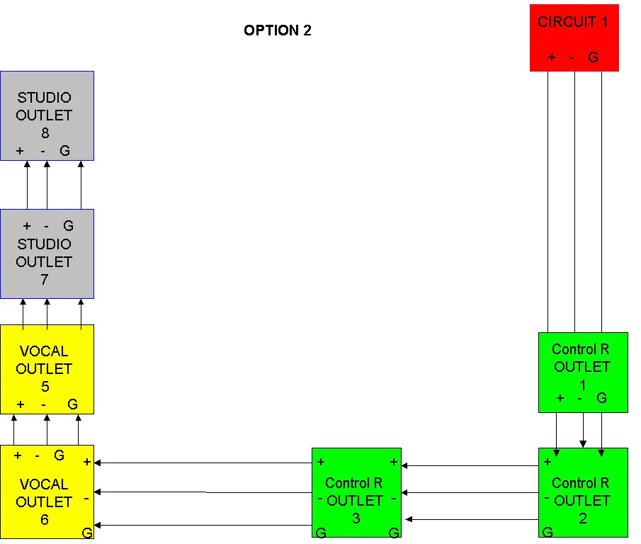

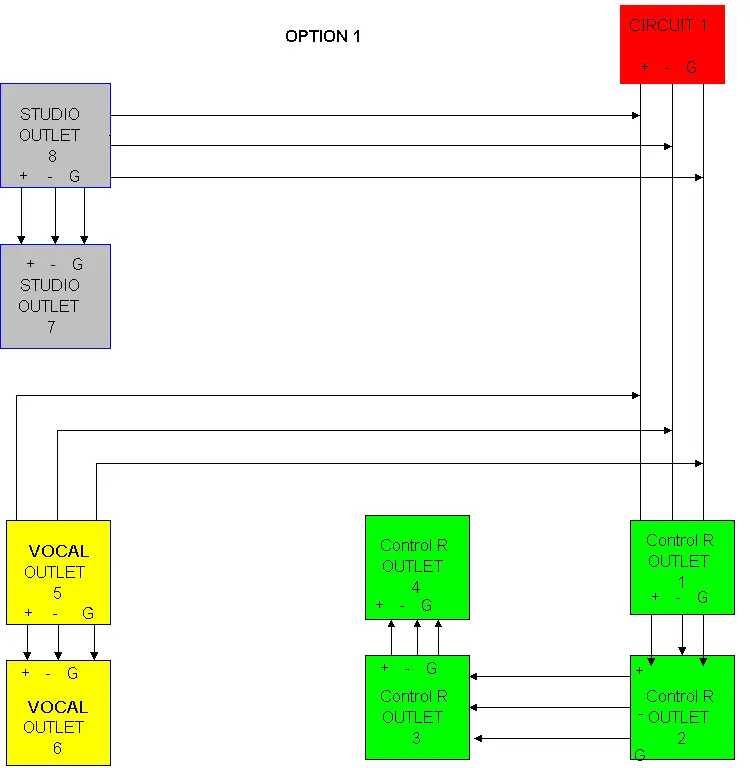

I need some help in trying to figure out how to setup the outlets for the control room- vocal booth - and studio. I will be using 1 circuit separated from the lights-and AC/Heat circuits. I know I need to setup the outlets using the star earthing technique....but now this part is what I am confused.
Please check the drawings and let me know which option is the correct way to do it or if both are wrong. In both cases all outlets have 1 common ground at the circuit but is it ok to connect grounds from outlet to outlet or do I need to extend a separate cable from each outlet's ground to the main circuit ground.

Here is the other drawing
Option 1

Diagram number 2. Using junction boxes is easier when breaking off into other rooms. Since all your ground is returning to the common in the circuit breaker box you shouldn't have a problem. Im using 3 separate breakers for my studio. 1 for lights, one for audio items and the other for accessories like drum machines, lava lamps, christmas lights, degausser and recorders. I don't have any problems with this set up.
SoMm
Yeah.
Man. I was majorly confused on this point once too.
From what I understand, taking a ground from outlet, to outlet, to outlet, and then to the main ground is NOT the way to go. Doing that could induce a ground loop.
What I understand, is that you'd want to take EACH outlet to the main ground.

Michael,
This is what I don't get....I would think that even if you connect the grounds from outlet to outlet in series then connect to the main ground...such as option 2 in my drawings...all outlets will have a common ground anyways...I would think the only difference will be the cable distance from the ground of each outlet to the main ground. I don't know if that is a problem.

Michael,
OK, lets say you have 4 outlets in a series. Like in your diagram, option 2, for the control room.
Let's say the ground connection from outlet 2 comes loose. (Or looses contact, or wasn't really grounded well to start with.)
Because they are in a series, each one past the loose connection (outlets 3 and 4) are no longer grounded. But your equipment is. What ever is plugged into 3 and 4 starts searching for a ground; over and over and over. It loops. It hums.
See, that's why you can lift the ground on your equipment (NEVER a good idea, don't do it!!!) and eliminate the hum.
If I'm wrong, someone please knock me upside the head!

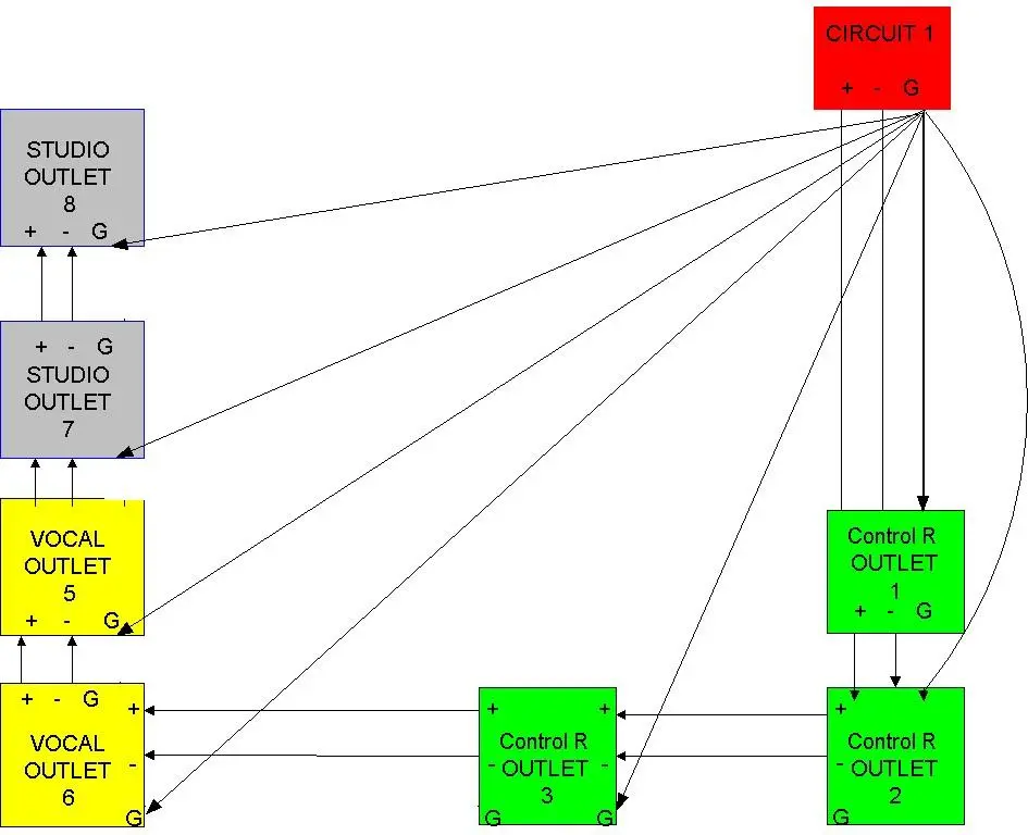

Luis - star earthing should work like this:
Cheers
JOhn

Ok I see what you mean....but ideally if nothing comes out loose and all connections have good contacts it shouldn't hum right?
Well, yeah, ideally.
But things happen.
Thanks John, I was JUST going to revise his drawing like you did.
Cheers
JOhn
Got it...I guess I need a separate ground cable for each outlet. Ouch!!!...that sounds like a lot of work.
Thanks John,
Luis.
I don't think that Micheal is saying that Option 2 is wrong, or that option 1 is wrong, what he is saying that potentially a ground loop hum could occur in both of those schemes if one of the outlets fails to complete the ground and it leaves averything down stream lost. (I could be wrong too) Number one will effect more outlets depending on where the grounds gets dropped.
The potential is there, buy using proper tool you can check the outlet for polarity and ground funtionality and fix it if something has gone wrong.

Son of Mixerman said:
I don't think that Micheal is saying that Option 2 is wrong, or that option 1 is wrong, what he is saying that potentially a ground loop hum could occur in both of those schemes if one of the outlets fails to complete the ground and it leaves averything down stream lost. (I could be wrong too) ... SoMm
No. you're right.
Option 2 would certianly meet code in my city.
But the potential for ground hum exists there.
More so in option one.
If the idea is to ELIMINATE the POSSIBILITY of ground loop hums, then star grounding is the way to go.
What you are saying, Craig, is run a separate 3 core feed to each outlet individually?? That's what we did at left bank - no grounding probs :)
cheers
john
c7sus
Wiring like you said sounds a little overkill to me. If there is a reliability issue with the receptacle down the road then he can easily pull it out of the wall and replace it.
But if you want to go overkill, be sure to use hospital grade receptacles. They never lose their retention and always make good contact… but overkill IMO.
And IMO if the ground wire is properly installed its overkill to run a ground line to the box for each receptacle. Just do the job right and there should be no ground loop issues.
