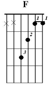

I just started messing around with my electric for the first time in forever today. I'd tune the guitar perfectly, just to hear out-of-tune chords.
For example, I'd play a C chord:
and the open G string would be out-of-tune. So Then I'd tune it up a little, then play an F chord:
Just to find the G string (now being pressed down) out of tune!
I opend a tuner vst and realized that when all strings were open, they were perfectly in tune. But anytime they weren't (ie my finger was pressing down a string), due to the pressure of my fingers, they would tune upwards slightly. So any note I played that was not an open string, would be slightly sharp. I know that this all sounds obvious, but how am I supposed to play chords on the electric guitar when they include both open and closed notes? That means that the open notes are in tune, and the closed notes are all slightly flat. I've tried simply putting less pressure on the strings, but I cannot touch them lightly enough for them to truly be in tune.
For some reason I don't get this when I play acoustic, perhaps because the strings I use on my acoustic are much thicker.
Does anyone have similar problems? Is it my guitar or do I simply need to work on putting less pressure on the strings so they don't go sharp, or should I get a different gauge of string, or is this a fact of life that I need to live with?

With a very few exceptions, there is absolutely no reason a guitar can't play as in tune with a plain 3rd as with a wound third. (The exceptions involve bridges with a limited range of adjustability). Your guitar needs to be set up. If you are having problems in the first position, it is likely that the nut on your guitar is not adjusted properly adjusted (which would be typical on a factory setup), though you could also be having problems with fret wear.
Of course, there is also the issue of what is "in tune." In the two chords you show there, in the C the g string is the fifth of the chord. In the F, the g string is the third. Thirds need to be a bit sharp to sound perfectly "in tune."
That is a part of your problem right there. Tuners are evil, pure and simple. Your guitar will NEVER sound in tune if all of the open strings are "perfect." If you want your guitar to sound in tune, you need to tune by ear, and if you don't know how you need to learn. Do NOT tune by harmonics either, as they will screw you even worse than a tuner will. You need to tune to a chord, and you need to experiment to figure out which chord, as it will vary depending on your style of playing. Hell, for me it frequently varies depending on the song I'm playing.
But mostly, what you need is to get your guitar set up with a new set of strings. If your used to playing acoustic, get a heavier set of strings on your guitar, as it will help keep you from pushing too hard, and it will improve your tone to boot.
