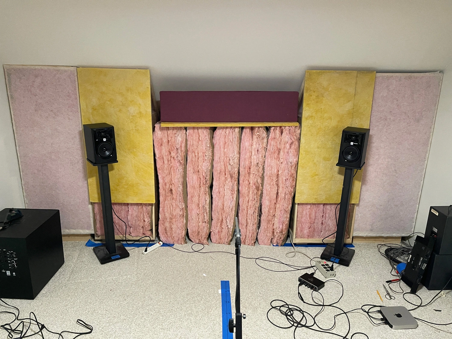

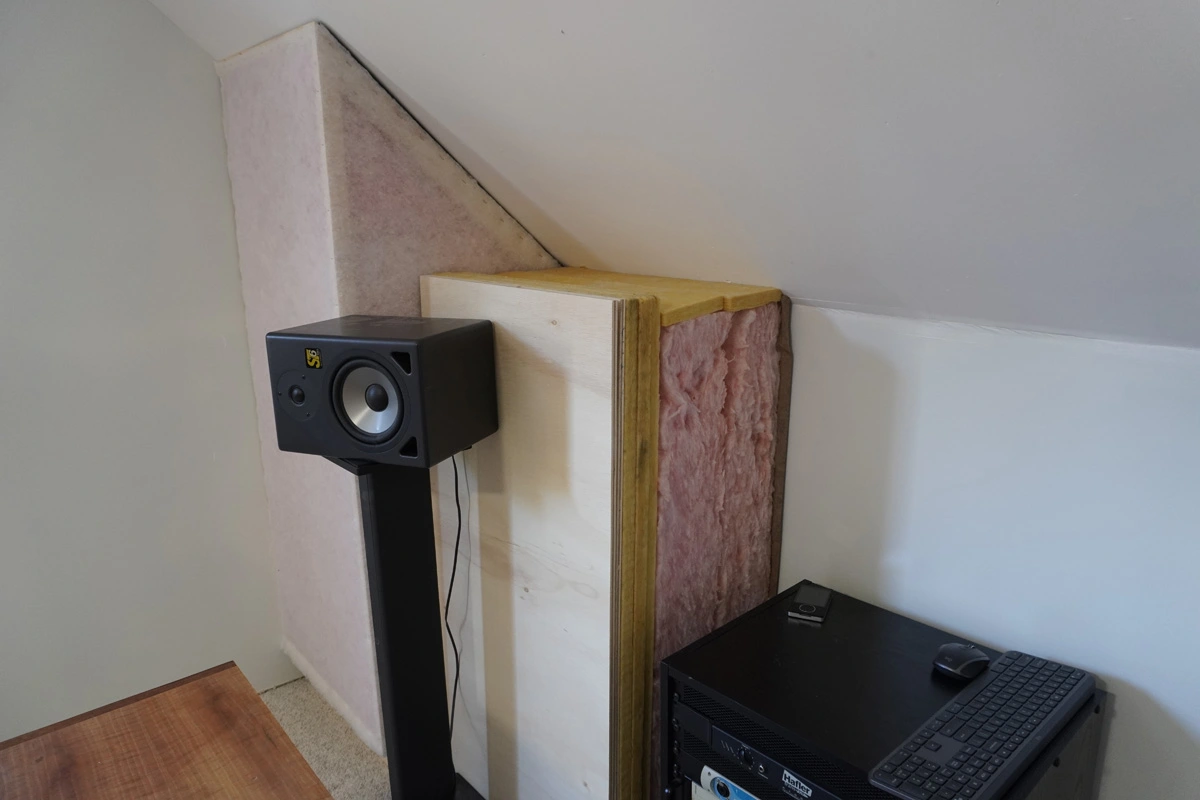

If you have a pair of monitors you like, one option you have is to build what would be considered a hybrid soft soffit of sorts. I am in the middle of a redesign of my attic studio space but what I have for monitors are temporary. So I did a lot of testing and mocking up various ideas. I've left the middle portion open in the treatment of the front wall just so I can build out a hybrid trap/boundary panel if I decide on something more midfield. A 1x1.3 meter hardboard panel will give you enough of a boundary and if the ceiling is similar to mine, will help reduce the interaction with the corner that is the kneewall/ceiling junction. The added benefit is that it could be built into additional bass trapping.
It would be pretty simple and cheap to mock it up and measure the difference in response. It won't deal with all the SBIR but likely enough to be workable and give you the added height for bigger monitors.
Move and measure first before making any decisions. Any issues you have now will likely follow with the new monitors, so better to understand the interaction of the odd dimensions of such a room first.
