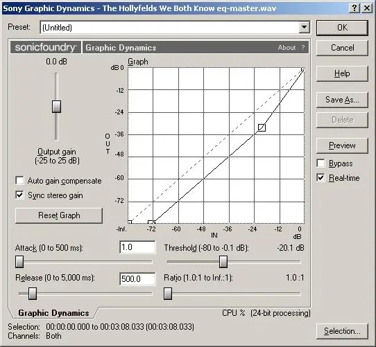

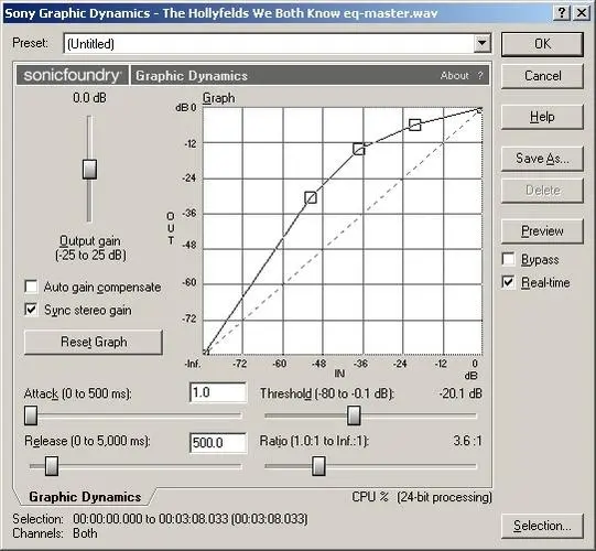

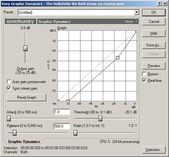

Well, if Bouldersoundguy has guessed right and you mean the ability to shape with compression with a variety of "knees", Audition can do that to like this:
It's only a series of straight lines because, for the sake of the pic, I didn't tick the box to set it as spline curves.
