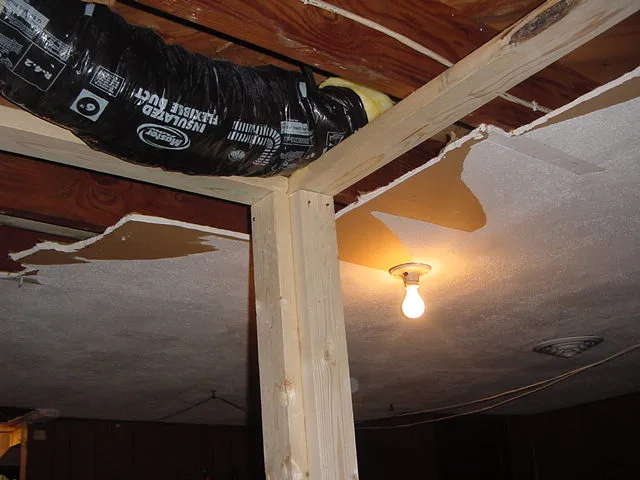

I'm building a basement studio and I need some advice on the best way to terminate the flex duct to a vent while retaining maximum soundproofing and space.
I want to put resilient channel and drywall on the ceiling, if I cut a vent into the ceiling, there will be a hole for sound to get through to upstairs - that is a no no. It's more important that there is more soundproofing through the ceiling than on the other side of the wall.
Is there a way to somehow route this through the wall and use the wall cavity from top to bottom? If so what is the best way to do this? My flex duct is 6" in diameter and I am using 2x4 studs. Keep in mind that I will also have to drill holes in the studs for electrical and cable runs.
Thanks in advance.

I'll try this again. Are these ducts connected to existing house ducting? If so, you've given a direct path for sound to the other rooms, thereby defeating all your soundproofing. If it is a seperate hvac system, then your planning is viable.(The transistion issue was of no concern if the ducting in the studio had already short circuited your soundproofing efforts.):rolleyes: And assuming you have a permit, then the documents you provided to BID, showing your hvac details, shoud provide the answer to your question.
fitz
yes, all ducts come from the same furnace, so I guess I'm screwed. I was hoping the insulated duct would cut down on sound transmission, I guess I was wrong, but I have no choice, I dont want to suffocate. oh well. Priorities are priorities.

Well here's what I ended up doing (see pic) - each "wall run" (from end of flex to where vent will go), was a total of about $15 at Menards -
1 90 degree boot adapter - 6" diam to 2.25"x12"
2 sheets of pre-bent sheet metal - 2.25"x12"x24"
1 90 degree register for vent - 2.25"x12"
duct tape to seal tiny air spaces
- this still allows space below for running cable
- this will eliminate the need for cutting holes in the ceiling.
There may have been a better way, but this makes the most sense for my budget and my situation.
mncheetah - Your solution looks OK, the only suggestion I would make is to use rigid fiberglass "duct liner" in that last peice (in the wall). It will help deaden the sound entering the flex duct.
