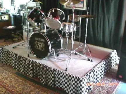

Another inexpensive Drum riser Design.
This design would cost about twice of Potsy's design ($80-$100)
but is totally portable and great for floor decoupling and live shows.
This is the old "Water Bed" platform design. I have found that a 6' X 8' platform will handle 95% of all drum kits. I used 5/8" OSB which has held up fine so far. Plywood would be better. The whole thing is held together with 8-drywall screws, which can be removed in minutes for complete breakdown into single sheets for transporting. The "water Bed" design involves notching out slots in your leg runners so when they are placed at a 90degree angle to each other they slide together and support themselves. Here are a couple PDF's which will explain everything in more detail. Also a pic of the finished product.
Adwaz- that's genius!:cool:
I'm gonna build one for my band's drummer for gigs!
Definitely falls into the "why didn't I think of that" category!:D
Oh, I forgot to mention that it also sleeps 4, comfortably.......
