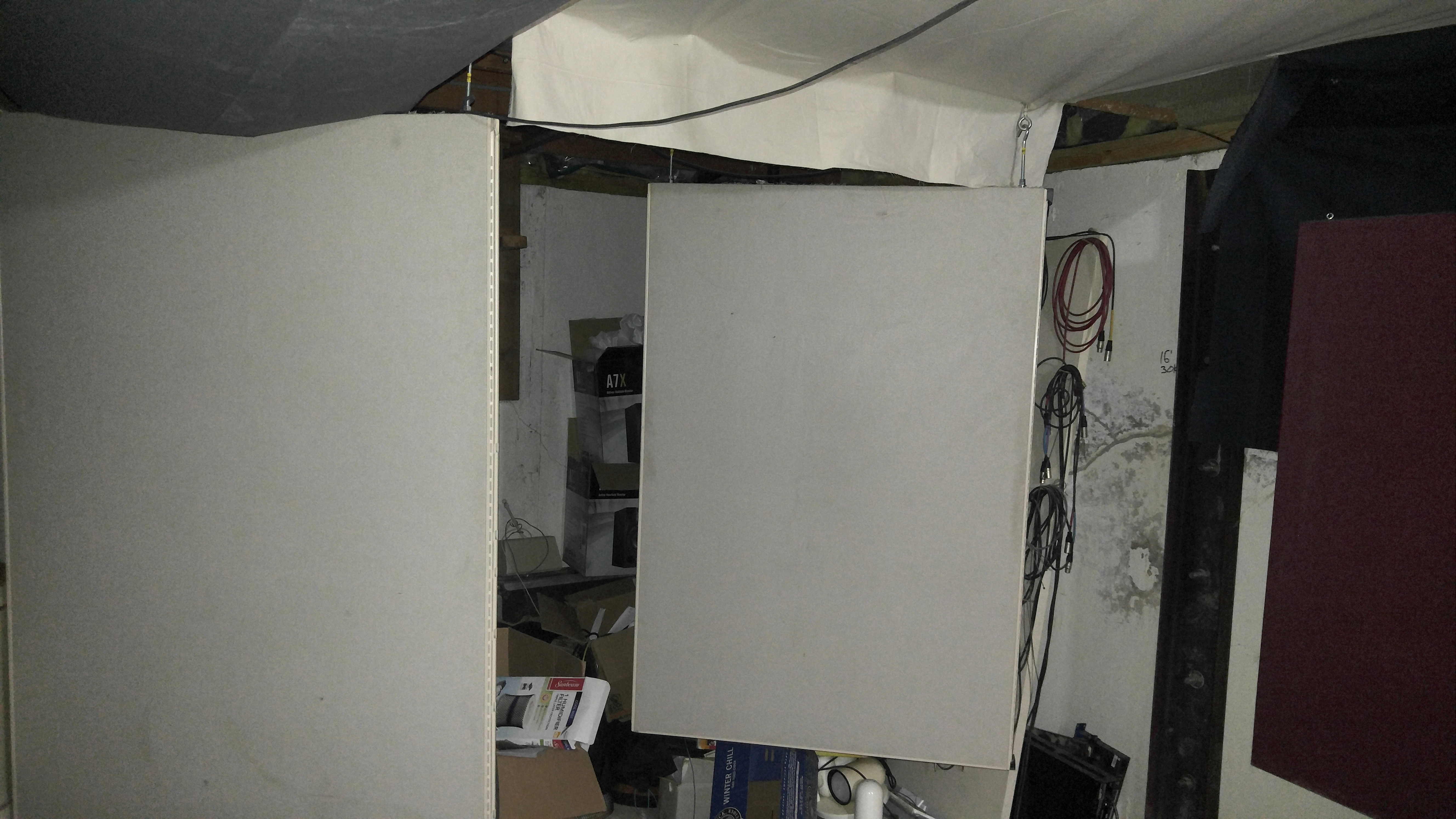

I have 4 office space dividers (the modular ones like in the movie) that actually work quite well for stopping direct sound transmission. I use them more to stop square wall reflections by hanging from the ceiling at angles. They were free on Craigslist.
Though, if cant find the office panels and want visibility, these could be just about the same cost as you are looking to build.

I have some panels I dragged home from work when they were tossing out some office setups.
They can be "beefed up" with some backing, and most of these types of panels seem to have basic fiberglass insulation, wrapped with some kind of woven cloth...so they can work well.
