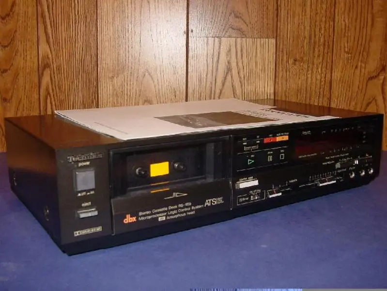

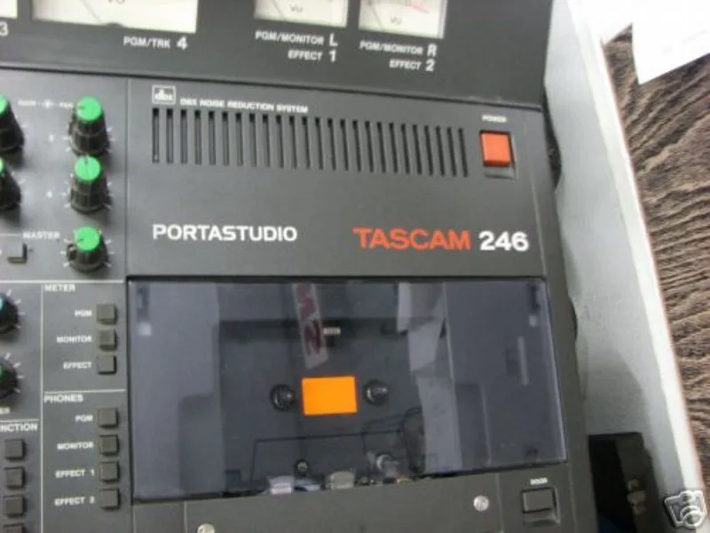

I've been happy with dbx NR on cassette, myself being a Technics and TEAC user from early on.
I agree that dbx failed in marketing terms, but was technically & sonically superior to Dolby despite it.
MO is that Dolby/B/C would never actually kill the hiss when engaged, but did other less desirable things to the sound. On the other hand, dbx completely adulterated the sound, but did amazing things in actual NR and headroom extension, the likes that Dolby could only wish for.:rolleyes:;)
I'm pretty sure both dbx & Dolby/B/C NR will mistrack when pushed out of it's normal operating range. Dolby might be more forgiving, (but IMO why bother?):eek:;)
For my money, I'll stick with dbx.
