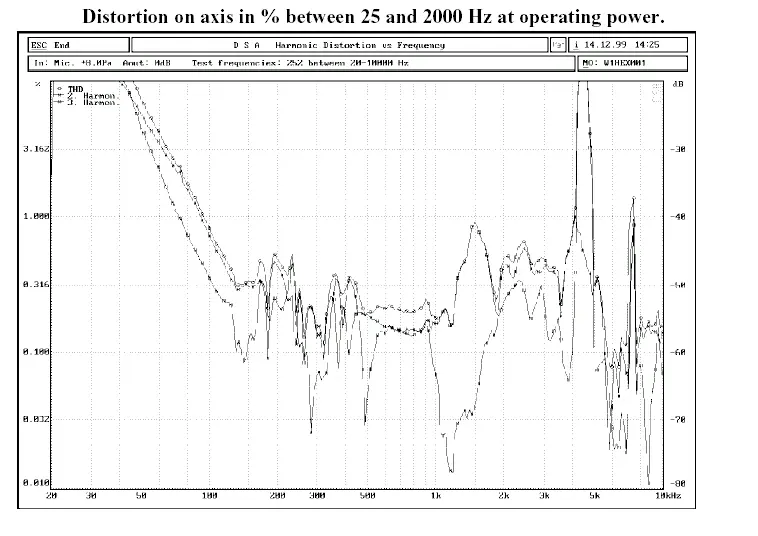

Distortion Measurement
There are various techniques and a lot of specific issues but in its most basic form you drive the speaker with a sine wave and record the output with a high precision microphone. When you put that recorded signal through a spectrum analyzer you get a large peak at the frequency of the input sine wave and several smaller peaks resulting from distortion induced by the speaker. The heights of these extra peaks are measured relative to the height of the main peak and given as percentages. This process is done for many different sine wave frequencies so the percentage distortion values can be plotted a function of frequency. Often you will see the primary 2nd and 3rd harmonic distortion values plotted. Otherwise all the peaks are summed together and the total distortion as a function of frequency is plotted.
Intermodulation distortion is measured similarly except two sine waves with closely separated frequencies are used instead of a single sine wave. The harmonics of each of these sine waves are ignored while the sum and difference frequency peaks are measured to determine the percentage of intermodulation distortion.
I've attached a distortion plot for probably the best 6.5" midbass woofer available today. You can see THD is around 0.3% in the midrange. As you go down in frequency the distortion starts shooting up dramatically. It's about 5% at 60Hz. Now remember that this distortion is the harmonics of 60Hz. In other words, false signals at 120Hz, 180Hz and higher which are clearly audible at -26dB. And also remember that this is for the very best 6.5" midbass driver available. This driver has much better performance than the midbass drivers in a Mackie HR624 or even a Genelec 1030A, so you can imagine how bad their curves look.

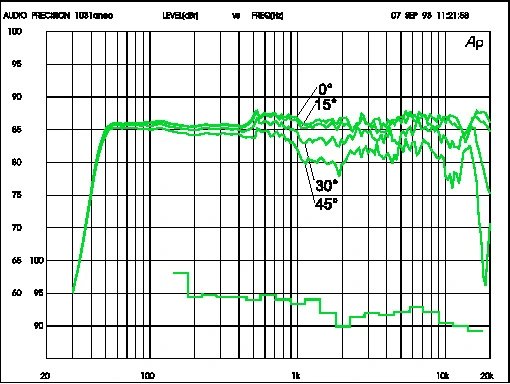

Every answer includes a new question... attached is the freq.response... the mountain at about 520Hz would probably be what you're saying? Before that mark the response looks clean, after that, it looks like a Belgian higway :cool:, but I guess it's all in perspective, these are dips and bumps I don't hear, right ?
No, you definitely hear those bumps. They make up the characteristics that still clearly differentiate the sound of different speakers all having relatively flat reponses. The bumps result from a variety of factors including dispersion (directivity) variations, distortion and resonances. There may also be some measurement artifacts in there as well, especially close to 20kHz.
The change at 500 Hz might have to do with better controlled dispersion and reduced woofer cone resonances below that frequency, but it's hard to tell. Convoluted in this graph is also likely a difference in measurement techniques between the high and low frequency regions. Usually frequencies above 200Hz are measure in the normal way you would expect, with a test microphone placed 1 meter in front of the speaker. Low frequencies are more difficult because you would need an extremely large and extremely expensive anechoic chamber to avoid room effects in this region. So typically the measurements are done in the true near field with the microphone placed about 1 cm or less from the cone. The difference in amplitude is corrected for and this near field plot is spliced to the normal high frequency plot. Finally there's the likelihood with an Audio Precision measurement that there are more data points per octave in the high frequencies compared to the low. So there are lots of things to consider when trying to interpret even a seemingly simple frequency response plot.
