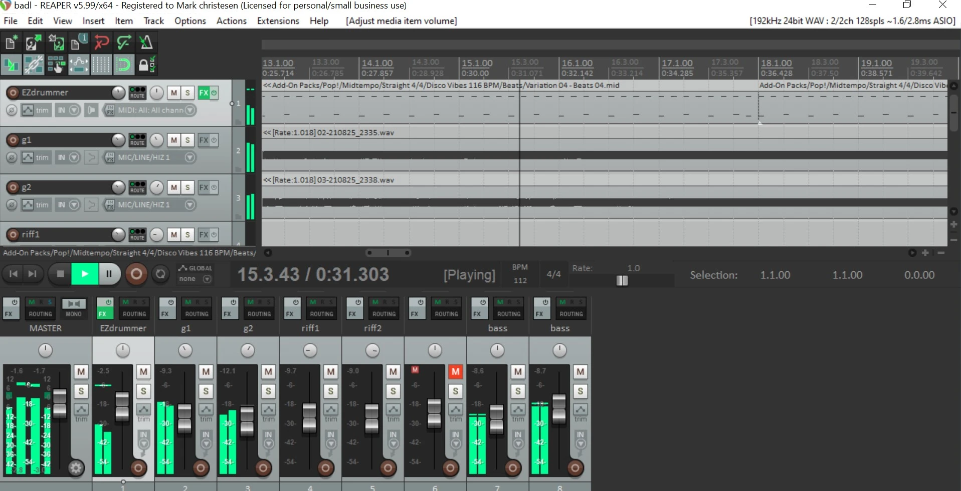

Today, I had some time to record . It has happened again. It slowed down. Or sounds like it. I was gonna finish the 3rd verse. But it is slowed.
The trip is that when I test it with an external metronome, it marches in time with the BPM selected. So, is it all in my head? Its all in my head.
I think it has to do with listening to it, to fill in small open spaces with sound, or listening to the thing as a whole presentation.
Latency was suspect, or too small a buffer. The DAW has Cracker Jack Timing at showing less than 2 ms latency.

If you're comparing it to an external metronome, then it clearly isn't running slow. Unless you are changing the BPM or changing the playback rate slider (youre still using Reaper, right?), then the timing should be constant.
