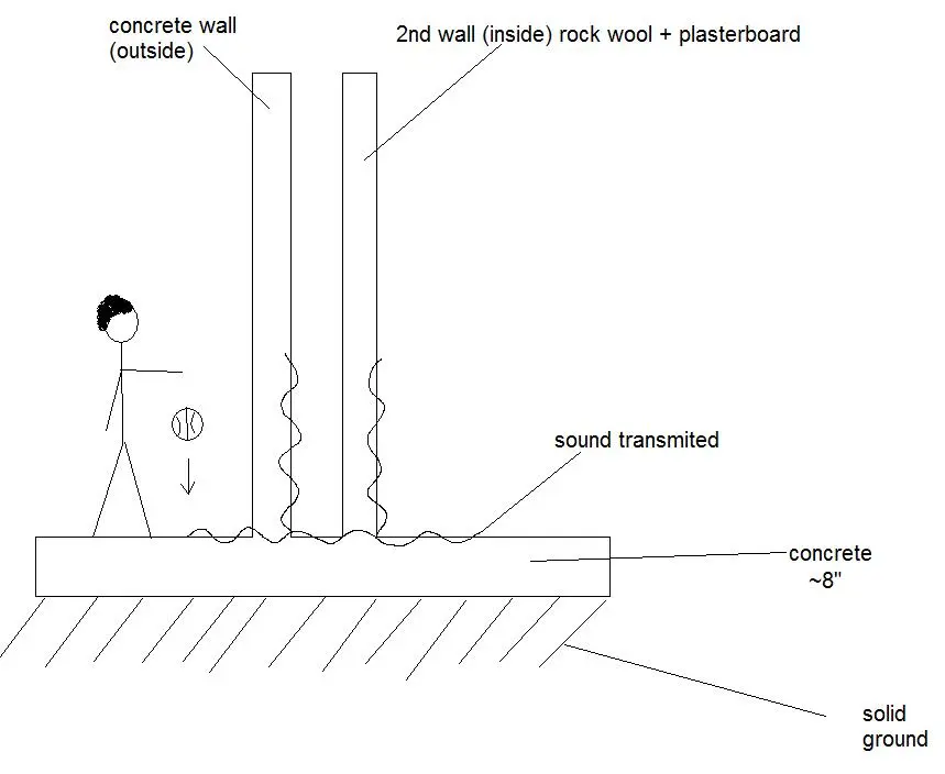

well its for a music school fitz, ( i teach the guitar there), the plan is to soundproof the room for rehersal purposes and then after a while use the same room as a live room (for recordings). i guess the soundproofing will have to be good.
i dont think there will be a problem with noise from the street afterall, because its a small street and cars go slow. Although on one side of the room there is a space where children play sometimes, so i m guessing that the worst scenario would be a kid bouncing a ball on the ground outside the room.
Do you think, something like what i draw on the picture can happen without a floating floor?
if you bounce a ball outside of the room now..(without the double wall and ceiling) you can hear the ball clearly inside the room...although i cant determine if any of the sound is coming through the floor....but there s definately a lot coming through the walls..

Tony,
why wonder? Identify the source - get a mechanics stethoscope and check the floor when the ball is bouncing.
