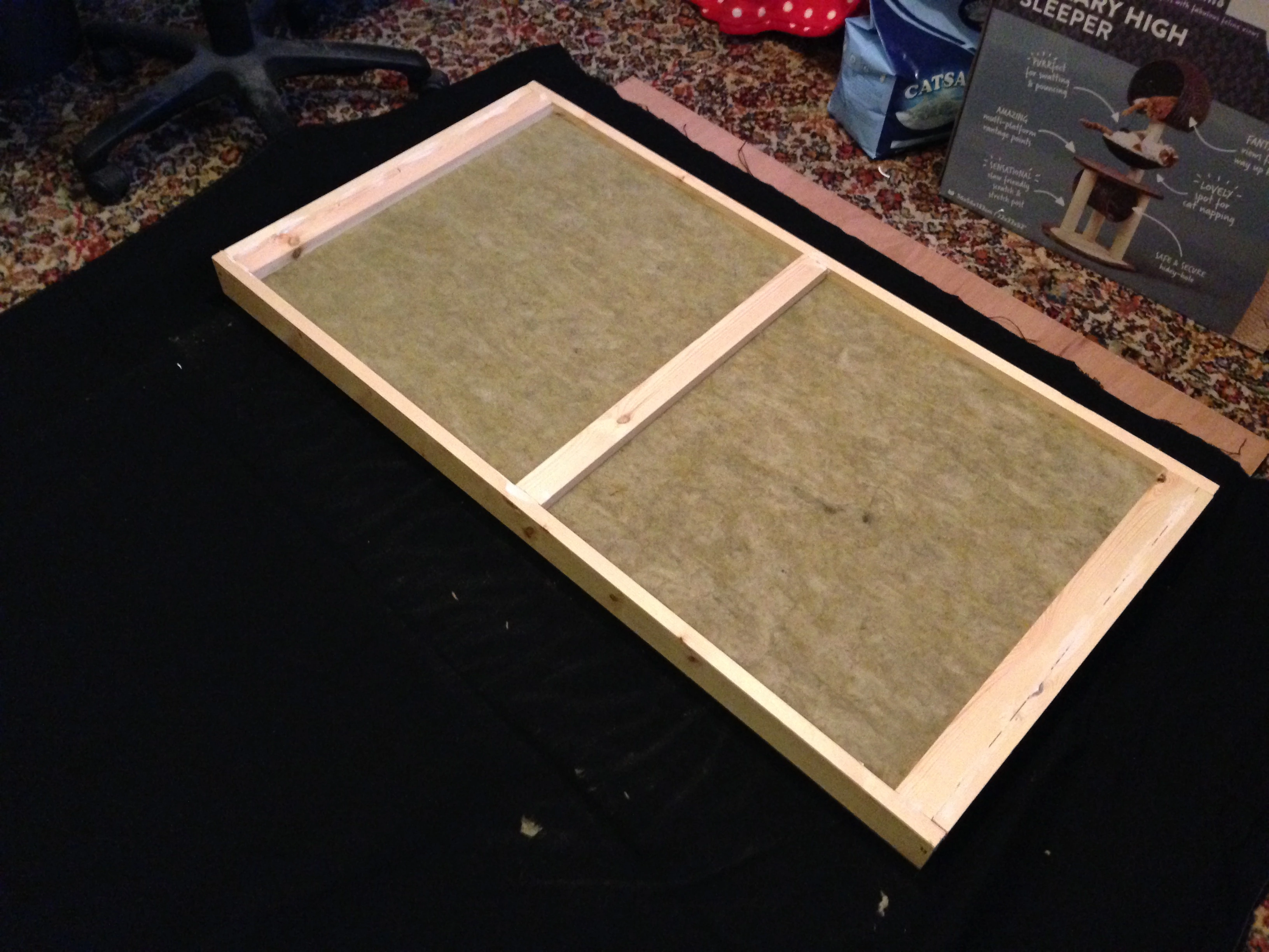

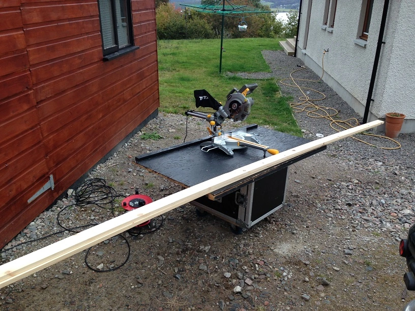

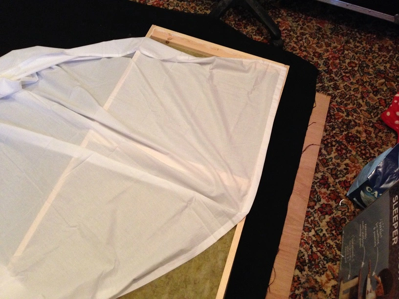

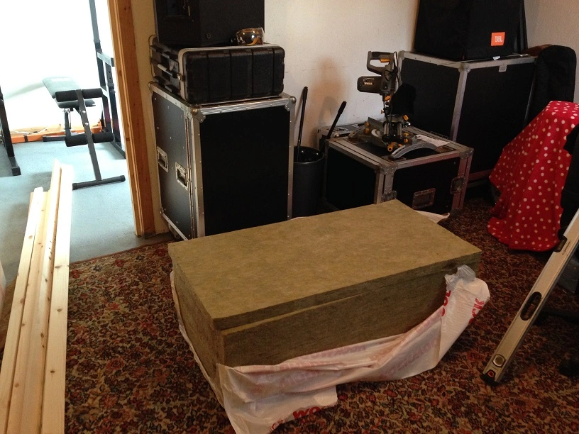

Hi guys, thanks for all the comments.
I've got 4 built so far, and am starting on the corners next weekend, as everyone has said it wasn't as hard as I anticipated :)
They've appeared in reverse order for some reason but you get the gist...
I used 69mm x 19mm redwood and 50mm RW3
Used an old sheep to cover the back and an acoustic material for the front, staples, brads and glue and that's it!
My wife helped out with the corners :)
Hung with picture hooks, easy peasy!
