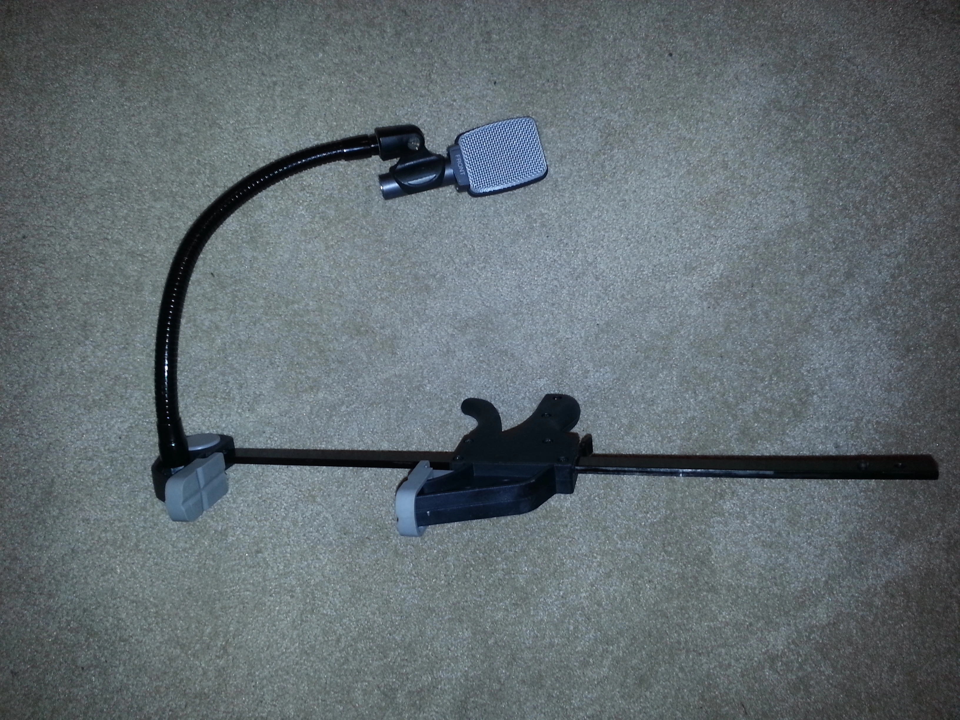

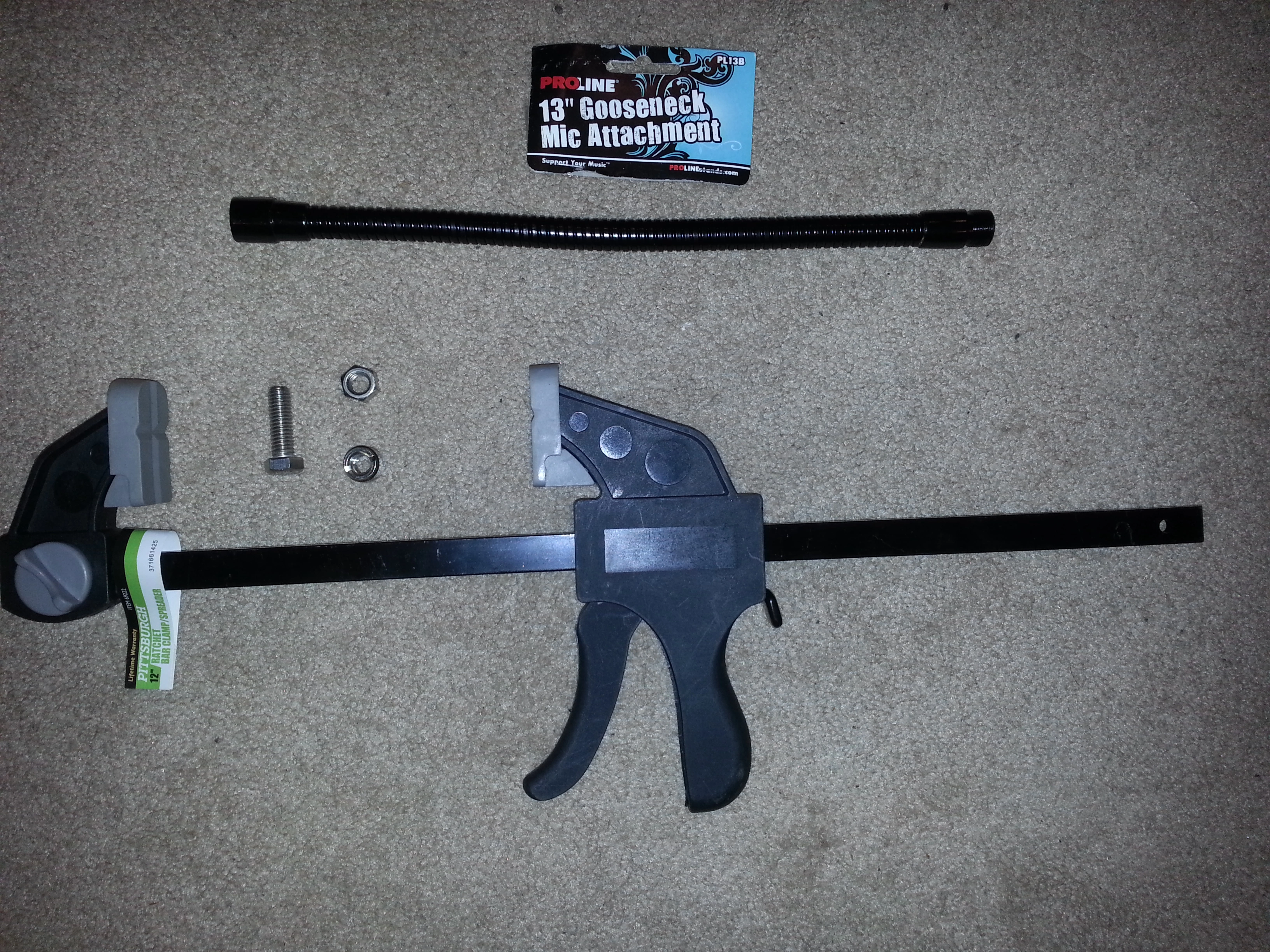

So I've been wanting to buy a couple of those Audix Amp Grabber things but was very hesitant to spend $50 on one so I went searching for alternatives. The cheapest is around $33 on ebay and very similar to the Audix. I also saw the Amp Clamp but those require drilling/mounting (or the price ends up the same as the Audix) and since I have vintage amps (and also do live sound for other bands) I really don't want to mess with drilling. Then I stumbled upon a DIY version which is as follows:
1 - Ratchet Bar Clamp $3.73 ea (incl tax) at Harbour Freight
1 - 13" Mic Gooseneck $8.86 ea (incl tax) at Guitar Center
1 - 3/8" x 1 1/4" Bolt
1 - 3/8" Nut
1 - Mic adapter (converts mic thread to 3/8". This is the adapter that comes with most microphones)
Access to a drill and a 3/8" drill bit
Drill a hole and assemble the nut and bolt. Attach the gooseneck and tighten.
Total cost $12.59
Total effort 10 Mins
Here's a couple of pics. Before and after.
I thought I'd share this as it saved me quite a bit money and was very easy to do.

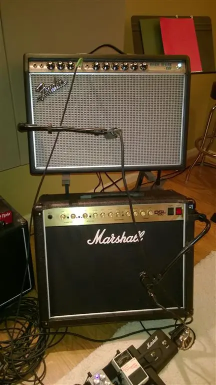

For instance, the position I currently have on my Fender is probably going to droop a little by tomorrow morning. But my position on my Marshall (angled downwards) has been in place for a few weeks now without any noticeable droop. Short goosenecks plus positioning that keeps gravity from working against you is the key.
