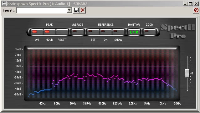

OK, here is the SA from the track "Fare Thee Well" off the new Mark Knoplfer(sp?) album.
This is his voice with no background music. It tends to lie in the 160 to 1.25 range. (Ss and Ts are the freqs on the far right, not as loud as the main range) This is a solo voice section. To carve a hole for this voice I would dip the music tracks slightly in this range. Actually there were a couple of key freqs around 160, 320 and 600 (very narrow Q) that always peak when he emphasizes a word. These would be the ones I would worry about getting covered up more than the whole range. So at the minimum I would build music tracks below 160 and above 600 to get the essence of his voice. This could be as simple as a dip on any instrument in this range to let his voice come through. He is a baritone, maybe bass by the way.
The SA really helps when you first start mixing to visuallize whats happening. After awhile you kinda learn where to go with the parametric and its not needed. Every once in awhile I pull it out if something is not working.
This SA is the Brainspawn SpectR-Pro 2.5
