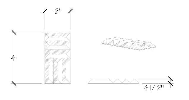

F foreverain4 New member Jun 20, 2002 #1 here is an idea i had for a diffusor. it would be made out of 1/4 HDF plywood, as to make it not quite so heavy. any comments are welcome. Attachments diffusor.webp 5.1 KB · Views: 91
John Sayers Solar Power!! Jun 20, 2002 #2 very cool - you could also vary the plywood thickness and make sure you glue insulation to the back of each panel and you'll have a low frequency absorber/diffusor http://www.saecollege.de/reference_material/pages/Low Frequencies.htm#panel cheers John
