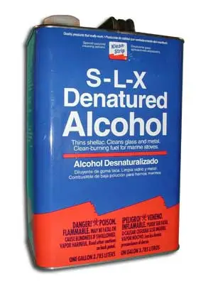

I used to buy it in little 2-oz bottles of head cleaner made by GC Audiotex, Which is denatured ethanol. I still have an old bottle that I refill with Kleen-Strip S-L-X. It consists of ethanol denatured with methanol.

Either 99% isopropyl or denatured is fine for routine cleaning. I don’t know of any incidents where it has damaged plastic, but I’ve heard that concern before. I’ve wondered if perhaps someone mistakenly used acetone or lacquer thinner, since all these cans look alike and are found in painting supplies.
uh oh.....mine says shellac thinner.....is that bad? I haven't used it much yet.
Another good thing about 99% isopropyl alcohol is that you can't buy a wrong one. With the denatured kind, it's a whole different story, as "antispatula" found out ;)
No... it is a shellac thinner among its many purposes. Mine says shellac thinner too. See previous pic.
"Thins shellac, glass and metal cleaner, clean-burning fuel for marine stoves."
