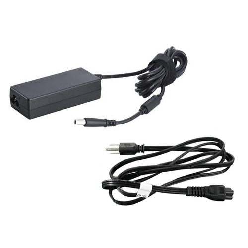

The 3 HPs in our house all have 3 prong connectors, as does the Dell in this topic: 331-0536r1.webp.
