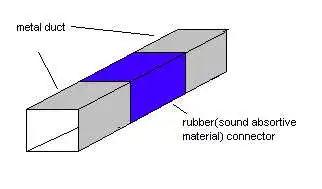

What is the best way to deaden sound transmission through ductwork - assuming a typical basement Heating\cooling system(furnace\central air unit indoors and every room sharing the same send and return ducts)?
Do they make a rubber type connector (see picture) that can absorb the vibrations(and withstand high temperatures)?
Any other ideas???
