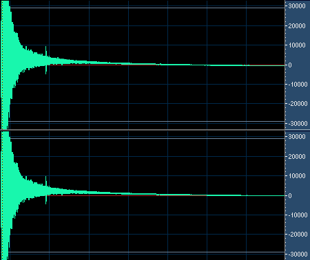

I noticed a long time ago that when I recorded something, the wave wouldnt be centered....like, thered be a wave that ends way up high (when actually looking at the waveform) and it gradually goes back to the center, and if i select it and go to Amplify and "center wave" it makes it look normal, and doesnt seem to change the sound at all. So why exactly do recordings do that? In preferences, it automatically adjusts DC offest while it records and I do that all the time now, but I really just don't understand what that is.....
Yeah, that gif you posted shows a DC offset problem. It's caused by the soundcard apparently, and Cool claims to be able to correct it by enabling "DC Bias Adjust" in Transform/Amplitude/Amplify.
The thing I don't understand is when the waveform's centred okay, but it's not symmetrical, and the waveform has loads of information above the center line for example, but not much below. What causes that? It sounds okay, but what does the irregularity in the symmetry of the waveform indicate?
that's what I don't understand. LOL when centered the wavs that were recorded like that, they would go up and down like a zigzag...but sounded fine....odd.

Hi TRK - that conversion idea is possible, because sometimes when it happens, it happens along the length of the entire waveform. However, sometimes it just happens on some sections of the track, as if the waveform is reflecting some kind of variation in the sound - maybe me moving around in front of the mic or something.
From the Cooledit Pro Help system... Thorne
Many sound cards record with a slight DC offset, which means that direct current is introduced into the signal by the card, causing the center of the waveform to be off from the zero point in the waveform display. This is seen as the waveform being “shifted” above or below the center line in the Wave Display, and can cause a click or pop to be played at the beginning and the end of the file.
