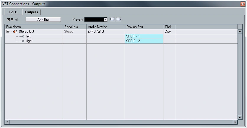

ou might also need to select Click in the Click column for the tascam in the Outputs tab. Just like I have for my EMU.
Yes, the Tascam is almost certainly not the problem. From the signal block diagram (p.23) the headphone amps receive a summed feed of all thru channels, or the usb return, or any mix of both.
This means that your monitoring is down to routing in Cubase, not the us-1800.
