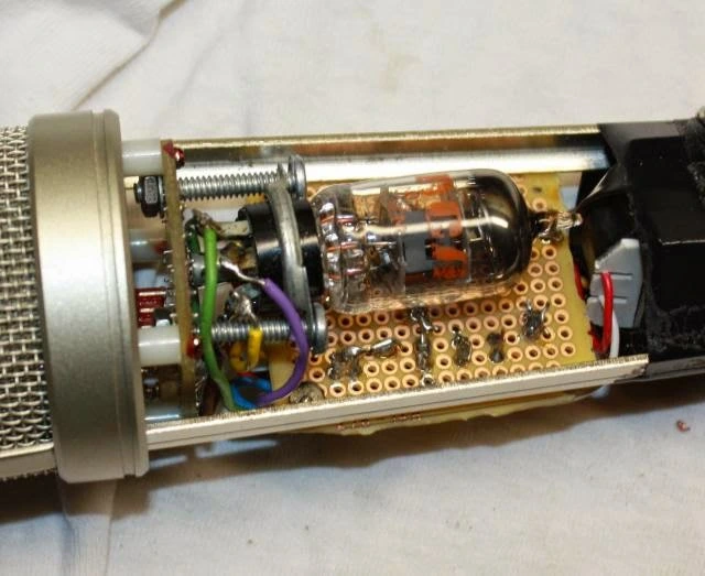

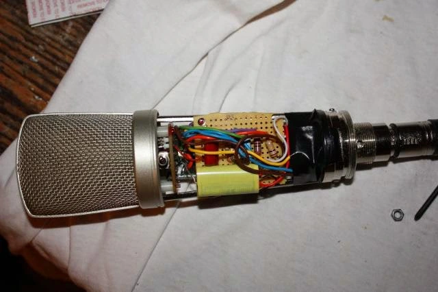

If you are into DIY, it is a fairly basic circuit, ala RoyerMod, U47, etc. Needs a larger donor mic, which in this case was a broken MXL V89MBP. The battery powered MXL mics have a slightly larger body, and they seem to come up on Ebay frequently enough in non-working condition. If you consider about US$65-105 for a new capsule and about $40 for a mic body, and use the Royer voltage tripler the whole thing should run US$150-$200.00, depending on parts and parts suppliers, whether you need a cable, etc, and less if you use the stock capsule. You will also need a transformer, which can be in the US$40-75 range. You could go much higher on a capsule.
I used a double sided capsule and the battery switch for a cardioid/omni pattern, so you'd need a double sided capsule. The full build thread is in teh DIY forum.
