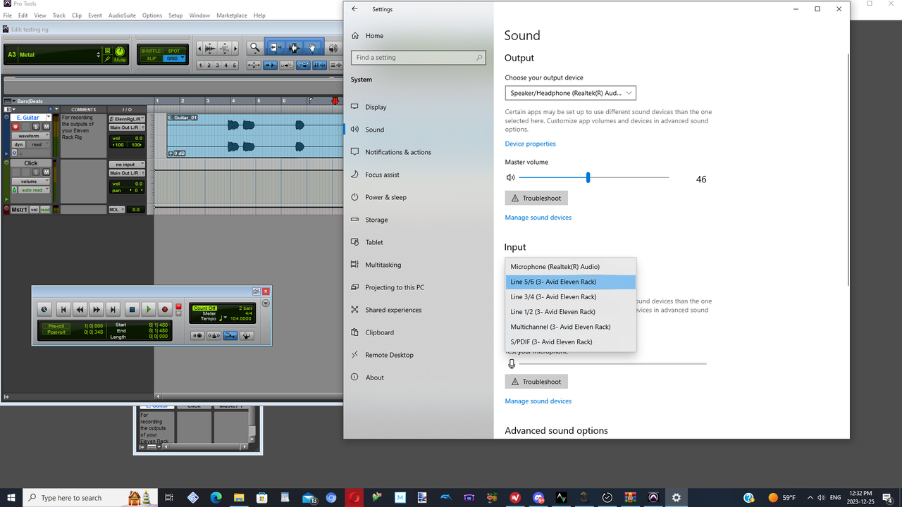

playing around with the au dio devices can this help or change anythig?

How do we changee the output of the eleven rack or pro tools?
Check the sampling rate on everthing. The DAW and interface has to be set at the same sampling rate or shit happens.
