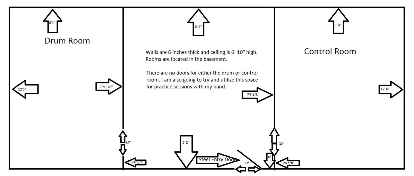

I have tried to put together a drawing of my bomb shelter. I plan to use room for recording my wifes band and also myself. This will also be used as a practice area when needed. I know it's not a nominal space but it can be done.

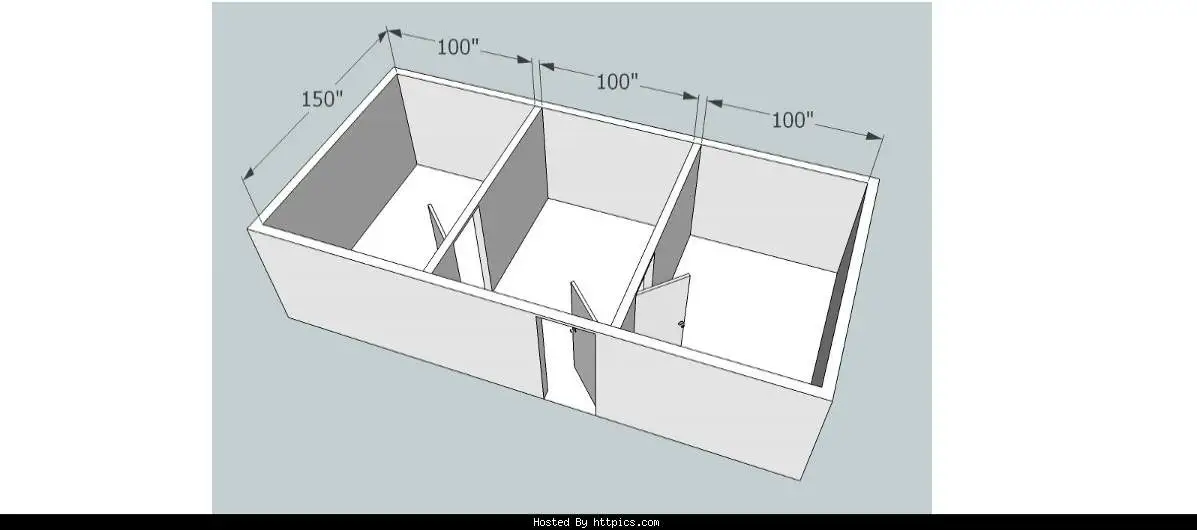

Cool. I'll be back in a while, but in the meantime I've taken the liberty to start a Sketchup file to work from for illustration purposes. Nothing I put in here is set in stone. Just to see the spaces you are working with. Anyway, if you could answer the rest of the questions, it will help me help you.;)
Have you ever had a 4-5 people in this space at the same time?? Doing some physical activity?... Just thinking that you may have to spend some $$ on air handling/conditioning...
