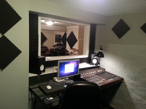

I just began the wiring phase of my new little home studio.
My goal is to record everything in analog on the 388, then be able to bounce all tracks simultaneously to the Firepod into Logic for finalization. I have basically set up shop like this:
-XLR panel on studio wall with 8 XLR inputs and one headphone jack.
-Panel connects to the 8 mic inputs on the 388, headphone jack to a stereo cable into the phones input.
-Main outs from the 388 to my monitors, the RCA main outs to a stereo receiver AUX input.
-Stereo receiver has speaker wires running to terminals on the control room wall that terminate on the other side (live room) to two standard stereo speakers, used for playback monitoring.
-Individual "Tape Outs" from all 8 channels on a snake to the Presonus Firepod's 8 inputs (front inputs, unfortunately)
1. Is there a way to separate the balanced main outs and the RCAs? In other words, if I wanted to monitor in both places it's fine. If I wanted to monitor just in the control room it's fine too. If I wanted to monitor just in the live room, I can't shut off the control room monitors unless I physically turn them off. I have made them a bit of a hassle to get behind so I was hoping there was a kill switch somewhere on the 388 but I'm not hopeful...
2. The tape outs on the individual tracks are really just the individual channel outputs, right? I'm guessing this will work fine to the Firepod...
3. If I wanted to route the playback from the computer (or any audio from the computer) through my monitoring system, I'm guessing I'd have to run the outputs of the Firepod to somewhere on the 388... anyone know where that somewhere is? :)
I know it's not an ideal setup but I'm trying to work with what I have, and the computer was really the least of my worries, but if it's there I'd imagine it would be smart to be able to monitor its audio through my playback system also... Any tips would be appreciated. I'll get some pics uploaded soon.

Cool, thanks Sweet...
My biggest problem when I do this kind of thing is that I rush to get it done and get everything set up and in place (OCD-ish) so it makes it harder for me later on to fix something when I have a revelation :) I need to build a 4-legged stand to custom fit the 388, because it weighs a ton and I have it perfectly sandwiched between a bumpy concrete wall and half of a glass computer desk, which is also just perfect to the other wall (looks better than it sounds; worked out well). So I have no play with it, and it's on a double X stand at the moment so bringing it out to get to the back sucks. If I can build something that has wheels and fits the same width I'll be golden. Then I can get into the patch points easier...
I did read through the manual last night and I had forgotten about both the Monitor outs and the stereo buss ins. Had I not already done the above, I might not have wasted anyone's time! :)
I tested with the direct tape outs last night into Logic, and it worked, but I'm glad you just said something about not having any control over the channels because I noticed the faders and master LR weren't affecting anything! I will reconnect everything to the BUSS outputs. I was like, 'this sounds lousy...' haha.
