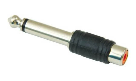

Run the L/R line-outs of your tascam into 2 line inputs on your tapco. It looks like the tascam has rca outputs, so you'll need a cable with rca on one end and 1/4" TS on the other. A set of RCA cables with a pair of these would do it:
Or 2 cables that each have these 2 ends:
I'd plug em into one of the stereo channels. But if you run it into the 2 mono channels, you'll have to pan them hard left / right or you'll end up recording a summed mono signal. (which you may want)
