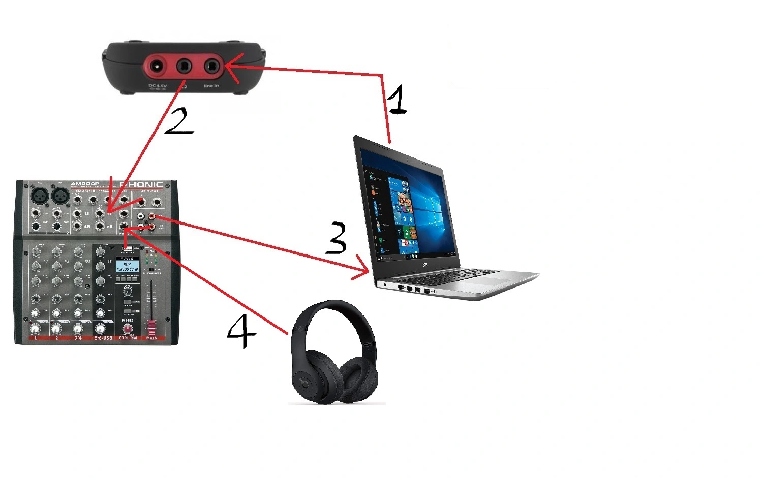

I searched and read some information on the link to make, I wanted to ask you if this is correct:
1) pc (headphone input) to kaoss pad (line in) - 1 jack 3.5 to 1 jack 3.5 -
2) kaos pad out to mixer (channel 3/4) - 1 jack 3.5 to 2 jack 6.3 -
3) rca out mixer to pc (mic input) - 2 rca to 1 jack 3.5 -
4) headphones to headphones mixer

Whilst that setup probably could be made to work (and there is no harm in trying) I doubt it will be ideal. You will be using the internal soundcard in the laptop, never the best idea and using dinky, fragile 3.5mm jacks to boot. There is also the complication that the laptop source will be stereo but, AFAICT the rest of the system mono, a situation that generally causes confusion.
Problem, my quick look at the mixer saw "USB" and I had assumed it was likemany such mixers in that it could act as a basi interface sending signals to and from the PC via USB. The Phonic does not seem to have that capability.
You would find your musical endevours far easier with an Audio Interface. The mixer will still be useful but routing signals far simpler.
If budget is a problem you could try the very basic Behringer UCA 202 a line level (-10dBV) interface costing around $30 but which gives remarkably good results. More money wil get you more inputs and facilities but do look into the market carefully and ASK HERE before splashing any cash!

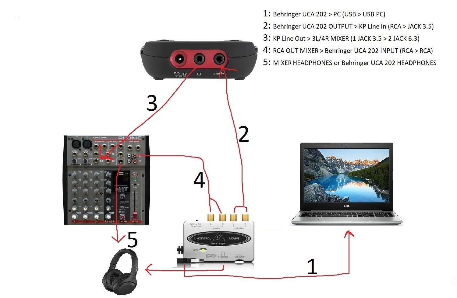

hey Dave tell me if this is the correct setupView attachment 107395
As I understand things, you want to send audio to the Korg, 'FX' it then record the result? Therefore I would send audio from the UCA RCAs to the mixer, send that out via AUX send then return to one or two mixer line inputs. Output mixer, RCAs could be good, into the UCA ro record an another track(s).
N.B. You might need "ASIO4ALL" to set this up on the PC. I am not familiar with Reason, I can barely use Samplitude and Audacity!
