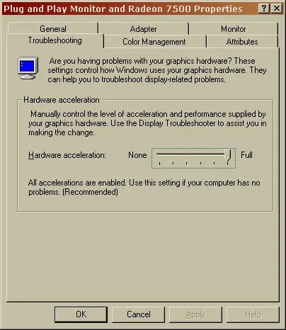

Look at the settings for your video driver. Is there an option to turn off hardware acceleration? Try changing it to a lower setting, or turning acceleration off completely. This is just a band-aid, but it would at least narrow down the problem. I've attached a picture of the settings dialog from a Win2K system with a Radeon 7500 video card.
After you change the setting, iIf the program (or other programs with similar problems) don't crash your computer, you can be pretty sure that the problem is in your video driver. If that's the case, the next step would be to check the manufacturer's web site to see if an updated driver is available.

......... i cannot find that screen
