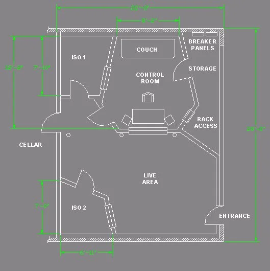

I currently have a 2-car garage under my house and I'm looking to convert it to a studio. The hatched area ///// is existing concrete wall. The house's main heating hvac runs across the ceiling. I plan to tap off that to heat the studio. I want to use suspended acoustical ceiling tiles and run track or recessed lighting. The ceiling will probably be around 7'-0" to get under the hvac, etc.
Any comments on the above, or the attached drawing are welcome. Also input on flooring material, etc.

I like it!!!
Just one question:
How are you going to get cables from the control room to ISO 2?
Run them across the live room floor?
Krypto,
My only concern is the angle of your control room walls. In front they angle away from the mix position, but they start to angle back before the mix position. Because of this angle you will probably get reflections from the speakers directly to the mix position.
You also might want to think about getting rid of iso 1 and using that whole area for your control room. It is easier to get a smoother bass response from a larger control room. Or, get rid of iso 1 and make the storage area larger and treat it so it can double as another iso booth.
Eric
The whole concept of control room shape is kind of new to me. I took ideas from other layouts I've seen and thought this could work.
I appreciate the input and will consider the shape a bit differently.

I'm curious about acoustical ceiling tiles, too.
In reference to the questions about the ceiling tile, the acoustical ceiling tiles should provide some mid and high frequency absorption, and will cut down on ceiling reflections. This would be similar in concept to the photos Ethan Winer has of his setup with his traps hung from his ceiling, I guess. You might be able to utilize the space above the ceiling tiles for bass trapping, also, and kill more than one bird.
