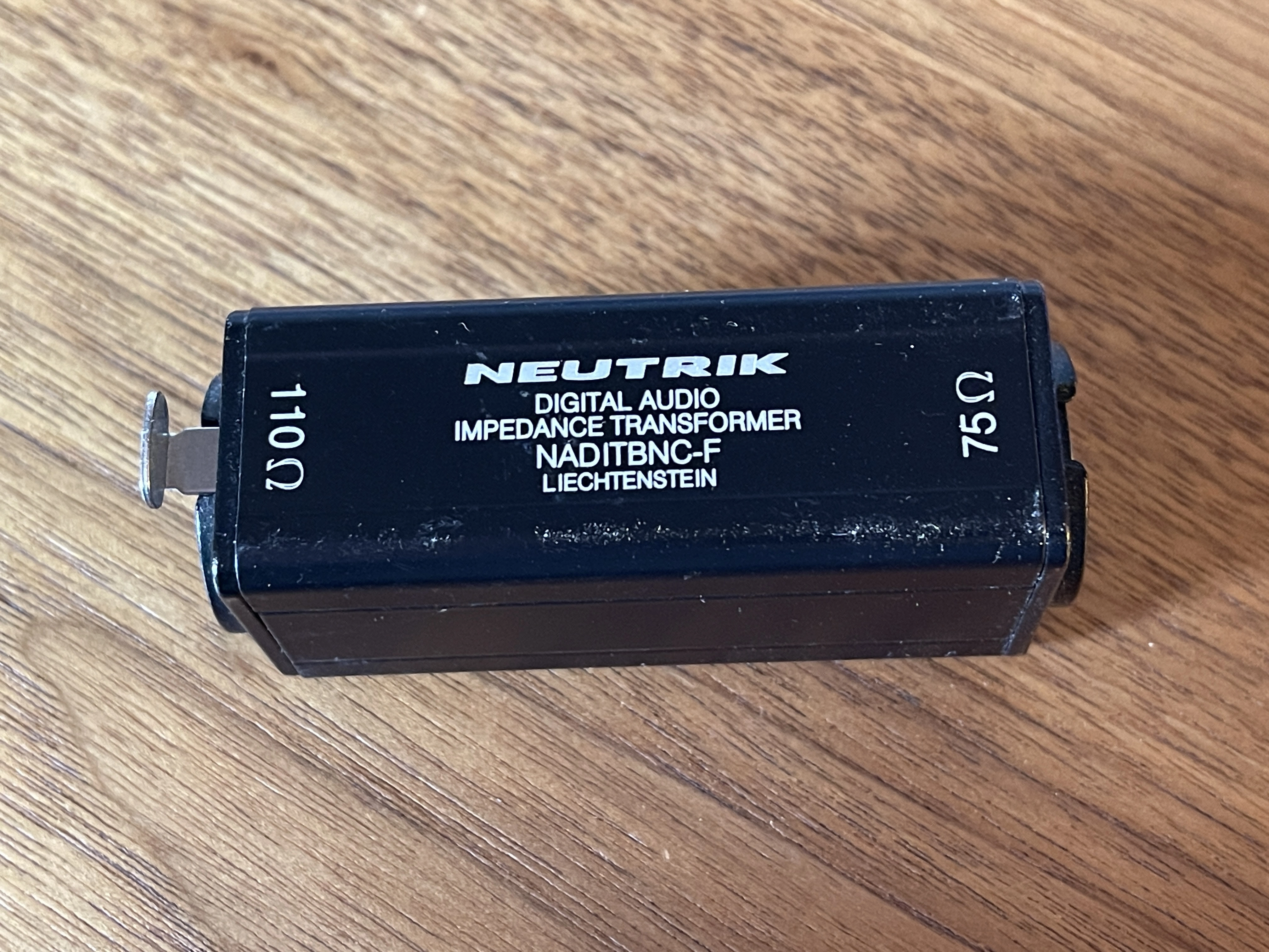

Oh this brings back memories of the early days of digital. It really was a mix of 110 and 75 ohm AES/EBU. Our surround sound processor was 75 ohm along with some other gear.
I used a lot of these to connect gear together.
