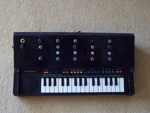

Here is my SA-8
This is from memory, so may contain minor errors:
Top Row: Jack out, Volume Knob, Reset button, Internal Speaker on/off, Power Led, 6V power in
Second Row: Feedback Knob, Feedback Amount, 5th (on/off/on), Distortion, Distortion Knob, Glitch, Glitch Knob
Third Row: Cowbell (extra sound), Extra demo 1, Extra Demo 2, Extra Demo 3 (currently incorrectly wired?)
Fourth Row: Hidden sound buttons (allows 100 sounds in conjunction with pre-existing blue buttons - instead of just 25)

It actually provides even more cowbell that you would expect:
1. The Green button provides access to a hidden percussion sound - I think it's a lofi sample - of cowbell.
2. The Blue buttons provide access to 100 patches, which is the full range provided by the Oki chip, instead of the standard 25 that are normally available through the standard front panel.
One of the new patches it provides - is called "Cowbell/Claves" (I know the names of these hidden patches because they are not hidden on some other casios in the range). As you can probably guess, this is a synthesized Cowbell!

Are the new sounds "easter eggs" that you exposed, or are they from other chips that you added?
