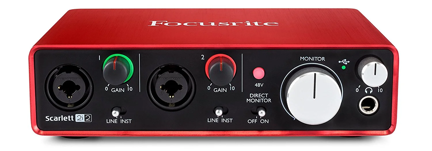

Since I have an interface (the one below), I directly plug in my electric acoustic guitar to the interface, which is then linked to the laptop with usb port.
There's no additional setting for the guitar.
Yes, that's exactly what it sounded like to me: a guitar with a pickup plugged into a preamp. So you get that nasty "instrument level" sound from the pickup directly into the pre. What you need to do is mic the acoustic in a room -- don't use the acoustic's pickup. Plug the mic into the preamp not the guitar. Then mic the guitar. Point the mic where the neck meets the body to start and move it as desired.
Then it won't sound so brittle and nasty.

It sounded better recorded, too, so I assume you did a traditional setup and sang into the mic. Make sure on the preamp (or in the software) you set it for "mic level" and not instrument level. Also make sure your levels are all okay (in the green on the Focusrite preamp knob).
