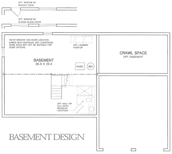

I am going to have a house built starting early next year and my question is this:
It will come with a full unfinished basement approx 26' x 23' with all the normal utility/stairs and what not. I can also add another area if needed/wanted. I attached a pic if you need it.
I have an option to have 9' ceilings instead of 8'. It seems that 9' ceilings would feel better, but would there be any huge advantage over 8'?
The main reason is $$. The additional cost of the foot is $8,000 to do and I'm having a hard time thinking its worth that much money to go from 8' to 9'.
Any thoughts and opionions welcome.

If you intend on doing a studio...spend the 8 grand, or spend alot of time and other money trying to fix the standing waves. You might consider designing the ceiling with audio in mind while your at it. It cheaper to finance new contruction while builing than it is to finance bandaid fixes at double the interest rate. IMO 9 feet is bare minimum even though 8ft is workable.

mate - if money is tight, and it always is, that $8,000 will build you a studio/practice room that will be OK IMO. Blue Bear is 8' and Bruce isn't complaining. ;)
If you are staring from scratch make sure you run the HVAC ducts along the outerwalls instead of the normal down the middle.

In the unfinished basement, this will actually be at like 8'-4"-8'-6". Then I will have to build up the floor, and then down the ceiling. How much thickness should I budget for the floor/ceiling construction?

Yea your probably right. In the bigger picture I will use half the LL for studio/practice room, the rest will ultimately be living/rec room. I should consider the overall uses.
Thanks for the help, I'm going to stop being cheap and pop for the 9' ceilings down there!!
