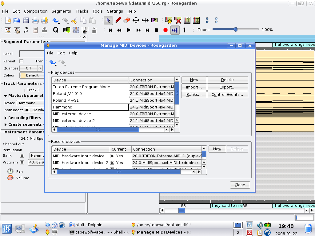

Below the 'segments' menu is a green icon with a keyboard merged into a circuit board. The caption is 'Manage MIDI devices'. If you click on it, you'll get something like this:
https://i89.photobucket.com/albums/k216/tapewolf/scraps/midi/rosegarden3.png
...if yours hasn't been configured already, it's probably got something like 'External device 1', 'External device 2' and so forth. Select one of those, and choose the interface from the dropdown. Since yours seems to be sounding, it's probably okay anyway.
Enter a name like 'Roland D110', make sure the item is highlighted, and click the 'Banks' button.

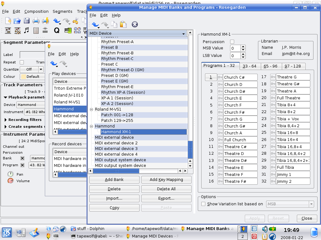

You should get this:
https://i89.photobucket.com/albums/k216/tapewolf/scraps/midi/rosegarden4.png
If you had an RGD file, you'd highlight the interface you named above ('Roland D110') and click on 'Import' to load it in.
Actually that might be an idea anyway, since it's got a default 'all numbers' program or something you can use as a template.

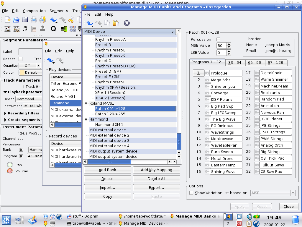

The interface you selected should have a branch appear beneath it ('Hammond XM-1' in mine), and if you select that (the bank) you should get the patch names appear in the right-hand side. These will probably be just 1,2,3,4 or something. What you can do now is fill in each one with the appropriate sound - there should be a list in the manual, or alternatively I think the D110 has a screen display so you can probably go through them one by one and fill them in. Tedious, but useful. When it's finished (there are tabs at the top to select more pages as it only displays 32 at a time), click 'Export' to save the bank to a new RGD file. Assuming it's all OK, you might want to offer it to the Rosegarden people for future inclusion.
Here's another example:
https://i89.photobucket.com/albums/k216/tapewolf/scraps/midi/rosegarden5.png
Anyway, when you're done and it's saved, press 'Apply' and close the dialogues until you're back at the main screen.

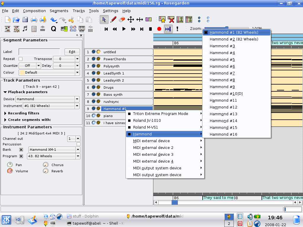

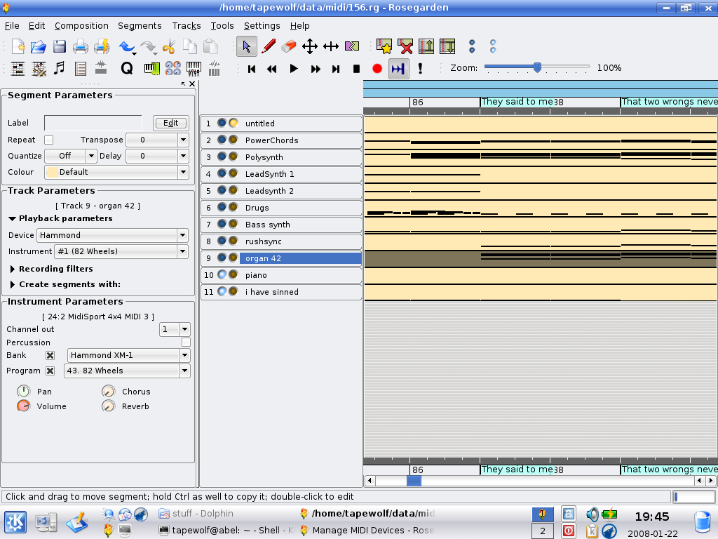

The next step is to set up each track to have the right instrument.
First click on a track:
https://i89.photobucket.com/albums/k216/tapewolf/scraps/midi/rosegarden1.png
...at the bottom-left corner you can see the bank, program and channel it's assigned to. If you've only got one interface, you can just go through each one, highlighting the track and changing the channel and program. You'll probably find that 'bank' and 'program' are greyed out by default. If you tick the box next to 'bank', you should be able to select your user-defined bank, e.g. 'Roland D110' or whatever. Then you should be able to activate the program dropdown as well, and you'll be able to choose the appropriate program from the list.
Rosegarden also has something of its own which it calls 'Instruments' but I haven't got to the bottom of that yet.
Anyway, you should be able to set the program for each track. Make sure you highlight the track before changing anything - sometimes I forget and end up changing the one I've just set by mistake. Also, make sure each track has its own channel or there will be a fight over which instrument is playing.
If you have several interfaces, highlight the track, right-click and you'll get this:
https://i89.photobucket.com/albums/k216/tapewolf/scraps/midi/rosegarden2.png
The first list is all the interfaces. The second list is all the channels for that interface. You can specify the interface and channel that way, although I think you may also be able to do that from the panel on the left.
...and that should be enough to let you select the instruments. It's quite likely that the D110 simply doesn't support GM, but at least now you should be able to choose suitable alternative instruments easily.
