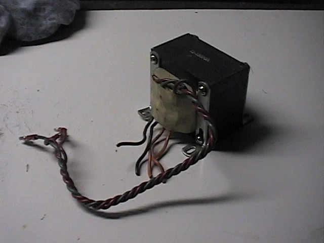

Hey guys, I did a stupid thing and blew my Carvin 200SX guitar amp. I know what the problem is, I just don't know what the part is called. I attatched a pic of it. Does anybody know what this is and if I can get the part at an electronics store?

Ouch! You blew your main transformer. I doubt very much you'll find the right transformer at your local electronics store. You'll need to know the output voltages and amperage specifications of the transformer secondary (the input voltage is applied to the primary windings while the output comes from the secondary windings). Better call/email Carvin for the right replacement transformer. Hopefully that's all that blew but chances are it's not if this part fried. Good Luck.
