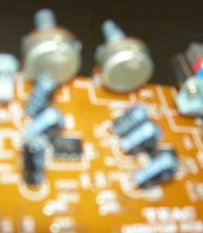

input pcb closeup capacitors copy.webpEXHIBIT A: these would be the obvious capacitors with polarity symbols (such as c126- sorry for the bad picture)), it has the dark circle on the negative side and shows a "+" on the positive side.

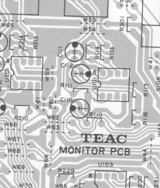

monitor pcb closeup capacitors w circle.webpEXHIBIT B: this is the actual capacitor that appears to be in 'backward' (circled blue, C112) , the positive side is in the black dot section. anyway, in this symbol there is no "+" but it appears to be polarized none the less with the black dot on one side. is the polarity on this capacitor important? and what if the capacitor that is in the actual board is in reverse polarity from the symbol on the PCB diagram and the symbol on the actual PCB board? (I got this machine from the original owner and I'm sure he never had it recapped)

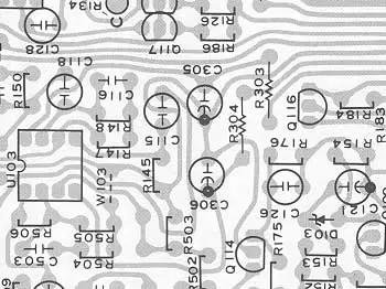

R.P.-pcb-close-up-capacitor.webpEXHIBIT C: here we have electrolytic capacitors that appear to be polarity inconsequent (such as C115).
so can anyone shed a little light on the polarity of EXHIBIT B and why one might have ended up in reverse of all the others? and for curiosity sake, what is the difference between the symbols with the "+" and the ones without.
I am going to be recapping this and it makes me wonder which way i should recap it: the way it was, or the way it "should be" according to the PCB's.

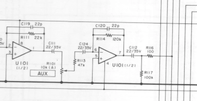

here is a sad attempt, if you have the manual you could see that the light strip side (negative) is on {what I understand to be} the positive side. (or you could just believe me). Its the only one I can find like this from all the boards I have out.

I get it. Well, it could either be that the
  • cap is installed backwards;
  • or the silkscreen is wrong;
  • or for that cap technology, polarity doesn't matter;
  • or, in that part of the circuit, there's no DC across the cap.
Can you measure the DC Voltage across the cap while the machine is powered up?

Go with the schematic -
I tend to rely on the schematic which shows the positive lead of C112 going to pin 7 of U101.

This appears to be an error in the silk screen.

This cap (C112) is an electrolytic coupling cap which "on average" has 0 voltage across it. It does get reversed biased for half of the time no matter which way you put it in. In reality it would be better to replace it with a bipolar electrolytic of the same ratings. But that may be overkill on this board.

thanks Ethan, for the clear ideas, and the suggestion to follow the schematic (and the extra info on the inner workings of capacitors!).
It does appear to be the case that the silk screen is an 'anomaly', but its only partially incorrect, I now see. I've been looking at the black circle (white on the actual pcb) because it was more obvious to my eyes than the bowed or straight bit of the symbol just under the actual capacitor (which is the 'real' marking of polarity I guess), so I suppose its just an anomaly, but not exactly printed wrong either. so I'll replace with the same polarity as it is (the old ones are still in the board) and as shown in schematics (and actually what the silk screen shows on the PCB board, but hopefully people here can understand how I was fooled by the misplaced 'black dot' on the board and the diagram:o).
I've scanned the manual to show this anomalous C112 symbol with pictures here: case closed. :cool:
